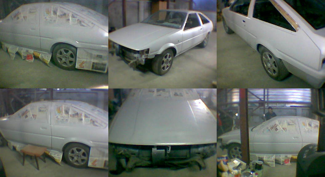

The problematic car:
AE86 GTS '84 Red Top
