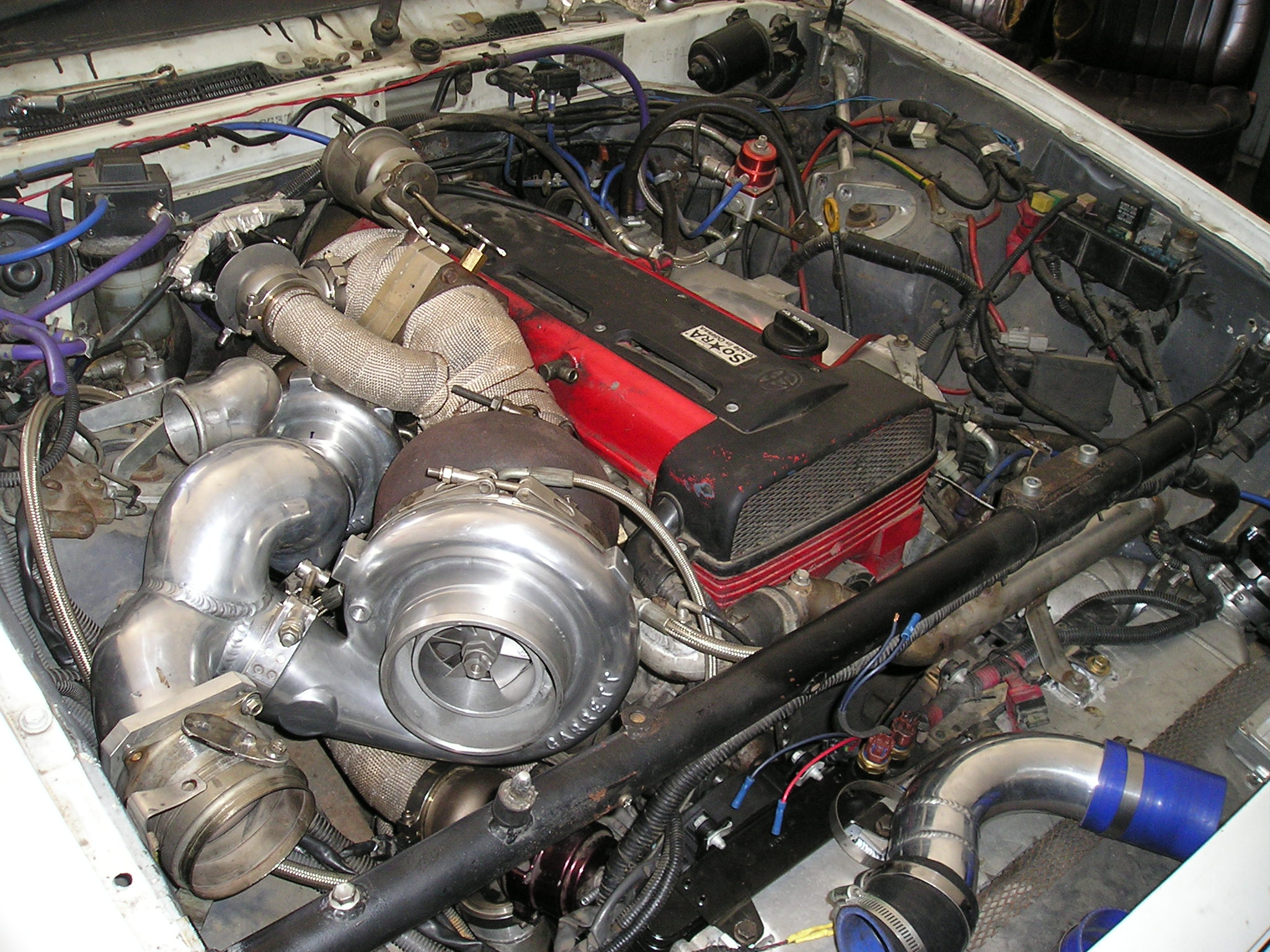

So, all is remarkable. 1 bar on 3200 . Then - as a steam locomotive

Why has broken? I say - a steam locomotive.. Just very fast
3000-5000 - gt3076
5000-7500 - gt4502
Two-level pressurisation Hurray!

a new setup for this season: the extra wastegate to regulate boost first stage .. Titanium non-return valve from the Russian helicopter Mi-8 .. and a new automatic transmission made ​​by Harvest
