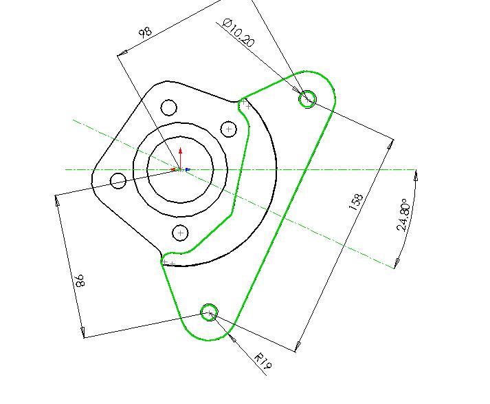

I had a little search arround to see what I could find out in terms of the bracket you need to machine to fit onto the front strut so you can get the caliper in the correct place.
I managed to find this thread on the Toymods forums. It talks about a the brackets required and one of the users Hen Bokbokbok took the trouble of making all the calculations and making plans for them !!!! Respect!
Please see the full details on Hens site. Please please please drop him an email and show you appreciation.
I have attached the actual images to this thread just in case they get lost in the big wide wilderness that is the internet (You never know - aeu86.org may still be around on the hachis 30th birthday). Could somebody check if Hen objects to this when they mail him (get him on aeu86.org!!!).
Hopes this helps somebody else continue this thread into a complete howto.
Regards Ian.
[Image: AEU86 AE86 - HOWTO: Mazda FC3S 4pot Calipers]
