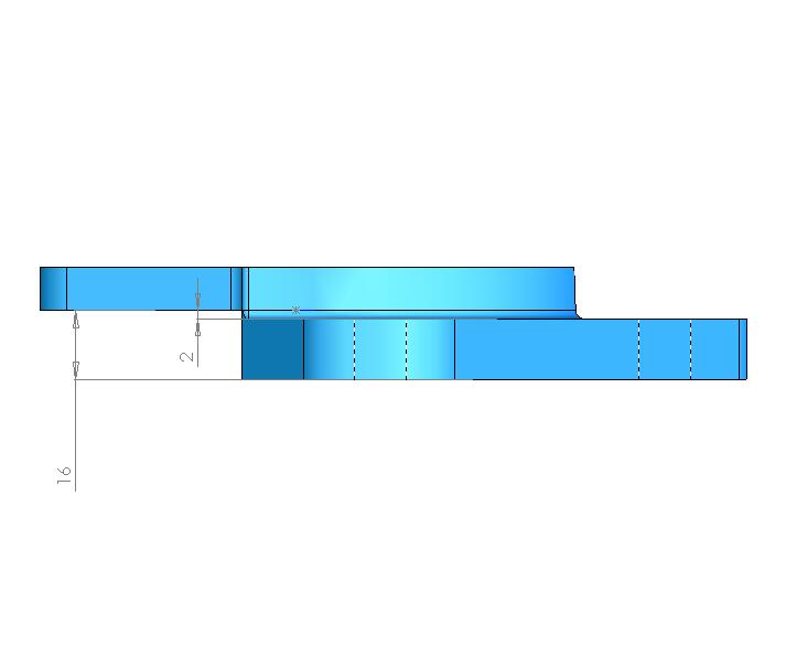

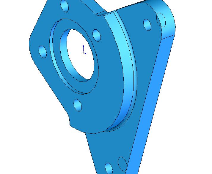

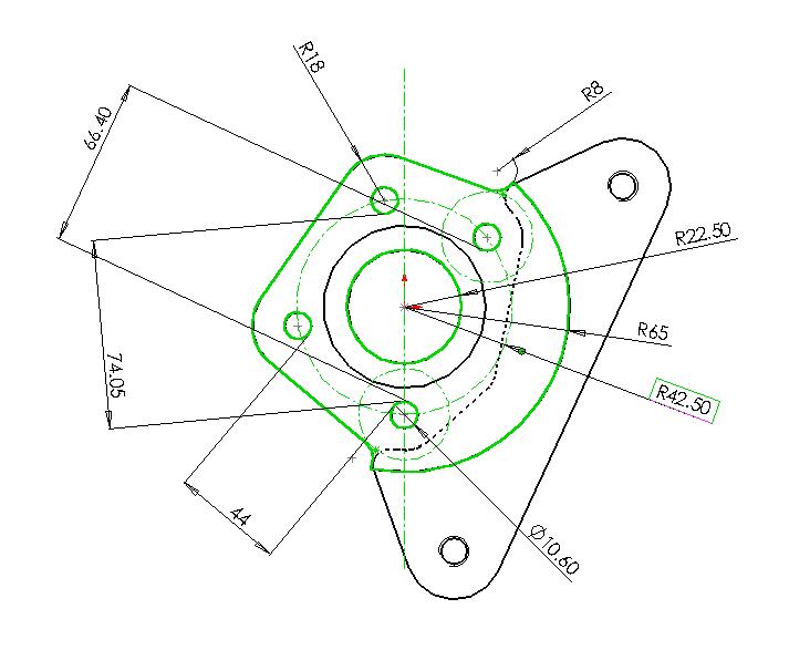

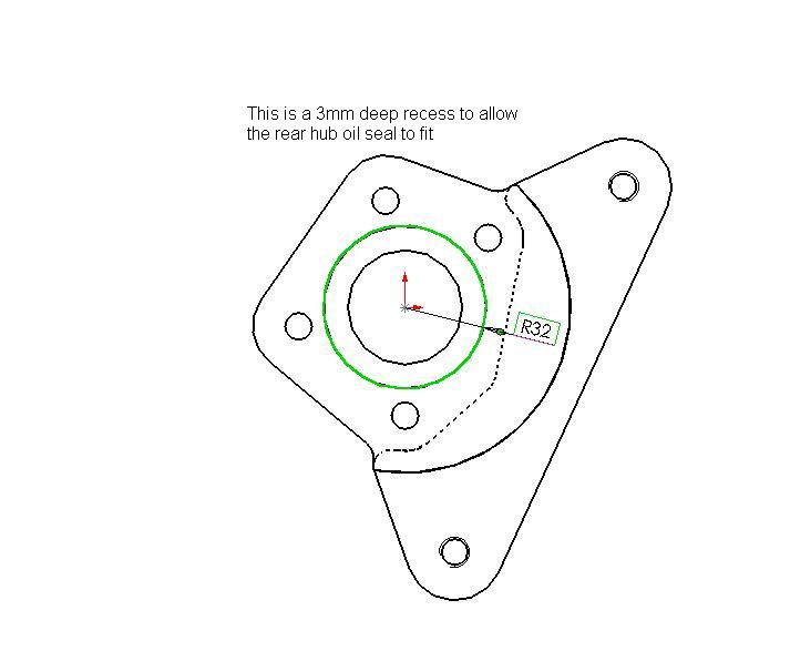

I had a little search arround to see what I could find out in terms of the bracket you need to machine to fit onto the front strut so you can get the caliper in the correct place.
I managed to find this thread on the Toymods forums. It talks about a the brackets required and one of the users Hen Bokbokbok took the trouble of making all the calculations and making plans for them !!!! Respect!
Please see the full details on Hens site. Please please please drop him an email and show you appreciation.
I have attached the actual images to this thread just in case they get lost in the big wide wilderness that is the internet (You never know - aeu86.org may still be around on the hachis 30th birthday). Could somebody check if Hen objects to this when they mail him (get him on aeu86.org!!!).
Hopes this helps somebody else continue this thread into a complete howto.
Regards Ian.
[Image: AEU86 AE86 - HOWTO: Mazda FC3S 4pot Calipers]

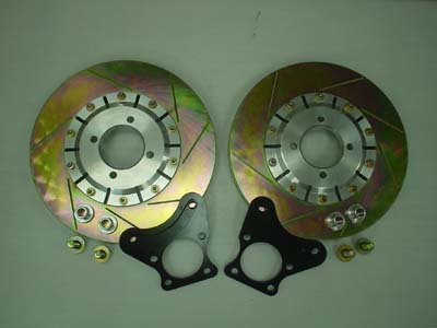

Also just found out that NAMS http://www.nagisa-auto.com/
Also do a disk/bell and mounting bracket to be used with the FC caliper too.
Regards Ian.

thanx Ian Thumbs up!
this wil help me a lot!!
are al sizes in 'millimeters?? ( i guess so?)

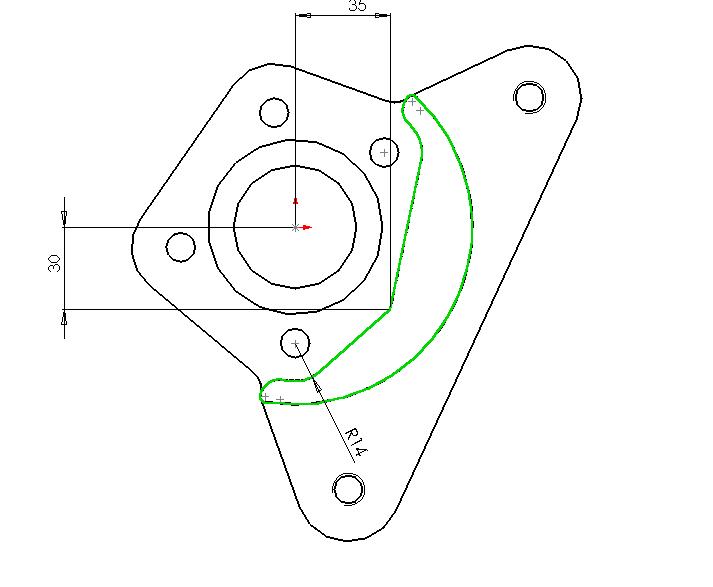

I've sent Hen a mail asking if he would object against a howto featuring his mod. Smile

Hey guys. Good to see that these drawings are helping more people out. The only thing I ask is that people don't try and make money out of them. But by all means use them if you can.
Yes all measurements are in mm. And that 24.8degree measurement is a bit of a strange one. If the bottom of the four mounting holes is vertically below the centre of the stub axle hole then the centreline of the two caliper mounting holes is 24.8 degrees below horizontal. It puts the caliper in the same position as stock.
And if anyone wants CNC code for them, I can provide the SolidWorks model of the part. In 2004 version I think, and no, I can't save it to .dxf, I've already tried.
Hen
