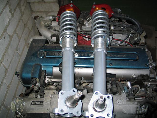

UHm.... That engine... Are you going to put it in the hachi or is it supposed to get in the supra? Tongue
07-04-2007, 12:18 PM
Post: #85
Greetings from Latvia
banpei Wrote:UHm.... That engine... Are you going to put it in the hachi or is it supposed to get in the supra? Tongue
2JZ engine in this picture is just background for important stuff Smile
p.s. as You see in pictures above, Fii owns 94 Supra TT. In picture is late spec JDM engine (with vti etc.) that evetually will find its place under Supra's bonnet.

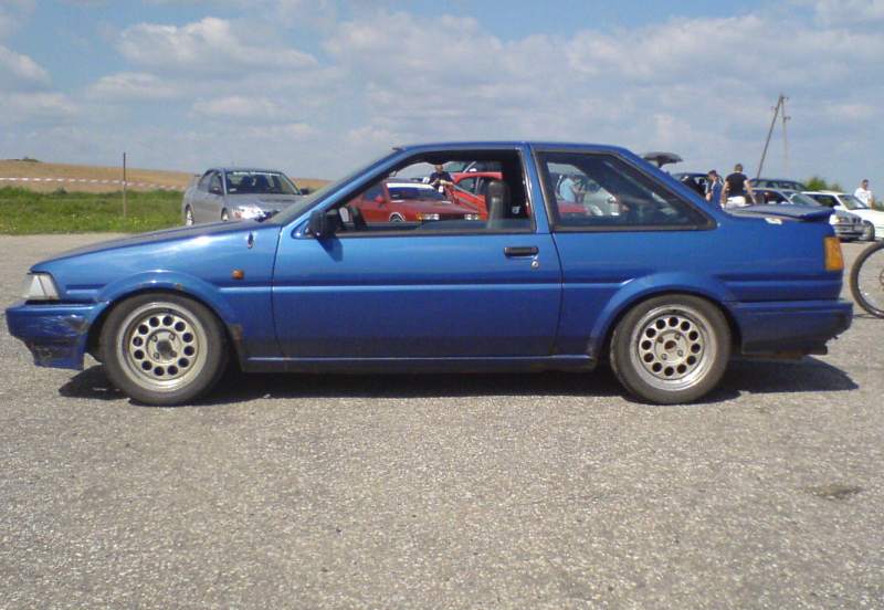

gt99 Wrote:Blue hachi isn't very competitive...
Unless You install bits from project car Smile
These suspension bits are :
Front:
Paradise Racing Coilovers 8 kg/cm with Tokico HTS shocks,
T3 camber plates
RCA (Roll Center Adjuster)
T3 Big brake kit with Wilwood calipers, Hawk HPS pads
Quaife quick steering rack
Cusco strut bar
Rear:
Swift 6 kg/cm springs with Tokico HTS shocks
Adjustable panhard rod
Prothane bushes everywhere.
Car is faster on track now. But poor Fii Respect! Now he has to drive car with quick steering rack + Toyo R888 205/50R15 everyday Huh

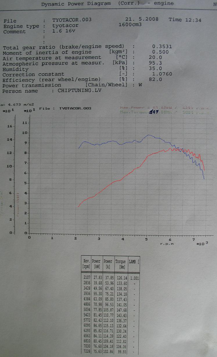

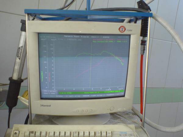

We were curious about engine performance because of smoke and engine's age. So today we measured engines condition on chassis dynamometer. Results: max power 115 bhp, and max torque 145 Nm on flywheel (calculated with 18% loss). Good overall result, but a little disapointed about declining torque line after 5800 rpm. Confused

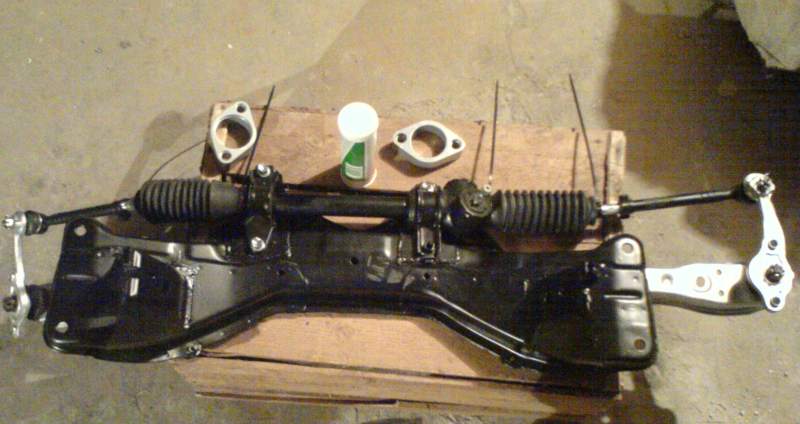

This year we did some "makeover".
Its not perfect , color doesn't match, everything a bit skew. But overall we are satisfied, car looks better
