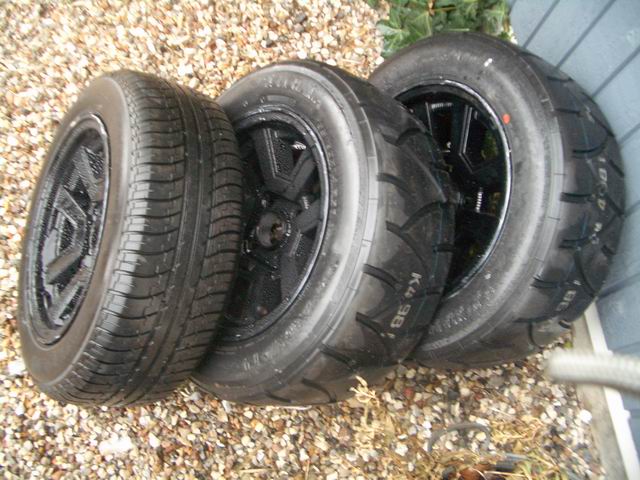

Got my supra wheels back from paintshop. on car pics.
Ivan141 Wrote:I kinda like them completely black Zax...polishing without a lathe will not be a fun job after it is powdercoated.
BTW, what kind of semi slicks are those on the supra's? Are those street legal? (might look nicer if you use some tire black coating on those tires)
I know....the pictures don´t really do them justice, doesnt look that much off in real life.
And yes, they are street legal, Yokohama a-038

Cool...then the Advan A032R's I have for the volvo are probably also street legal.. (no E-brand).

Advan tires are street legal. Just don't get the slicks.

better pics

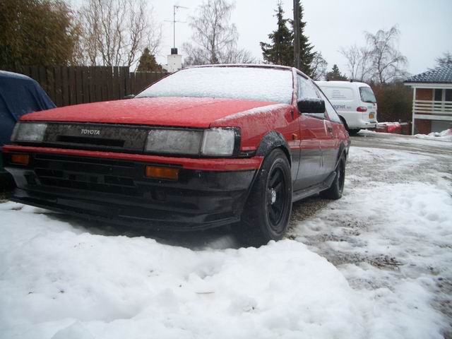

Mounted on car....with some difficulties i might add.....they do NOT fit at all, had to modify the fender flares, and still they dont fit all that good.

Hurray! very nice rims dude
veri nice tires too!! looks like a sort of intermediets(dit i spell this right??)

They are Yokohama A-038´s Soft compound.

Hi peter, what was the problem with the fenders, did the wheels catch on the edge ? If so what offset are the wheels

They scraped on the mounting points for the inner plastic fender. So i had to remove the inner plastic fenders, and bend the inner side of the flares, including the mounting points for the plastic. the ET measurement is +7 as on all supra 7x14" wheels. Another problem is that i have T3 NCRCA´s up front, wich actually leans the wheel a bit inwards on top, and should make them fit easier....so i´m guessing that if you don´t have these....they´ll never fit without serious flare modification.
