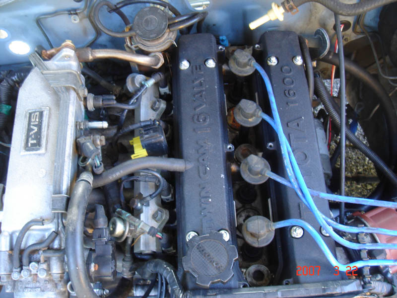

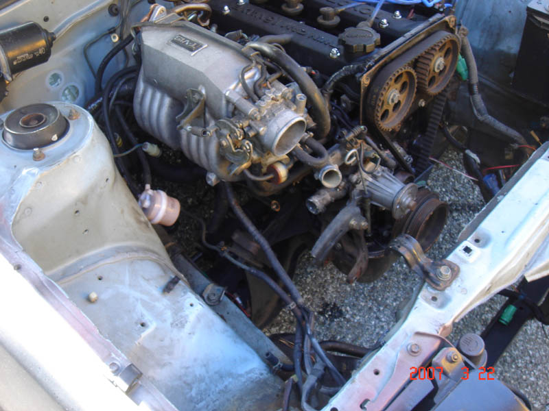

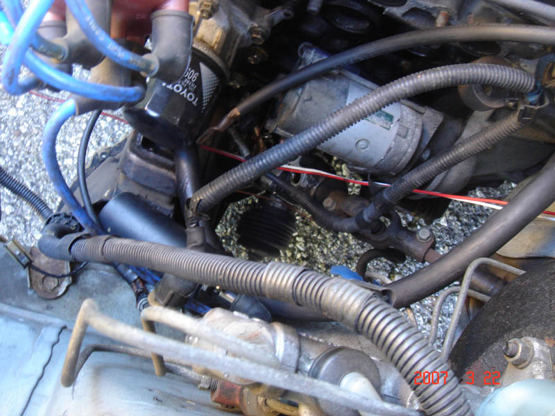

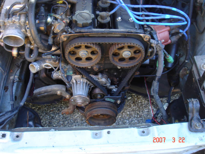

Background: I got this car for 500 USD. Came with a GTS transmission and a car battery as well as GTS fuel pump and GTS engine wiring harness. Car is not running and is missing a ton of stuff from the engine. However, it did come with a 4AGE engine.
[img name=]http://www.aeu86.org/files/ds/dsc04984_359.jpg[/img]
[img name=]http://www.aeu86.org/files/ds/dsc04985_198.jpg[/img]
[img name=]http://www.aeu86.org/files/ds/dsc04986_482.jpg[/img]
[img name=]http://www.aeu86.org/files/ds/dsc04987_161.jpg[/img]
[img name=]http://www.aeu86.org/files/ds/dsc04988_413.jpg[/img]
Wiring Harness
[img name=]http://www.aeu86.org/files/ds/dsc04994_634.jpg[/img]
GTS transmission
[img name=]http://www.aeu86.org/files/ds/dsc04992_131.jpg[/img]
Anyways I have ordered the AFM, Airbox, Hose, and Filter as well as an exhaust manifold. What do you guys suggest as the mode of operation? What would I do just to get the car running. Also there is an MR2 in the junkyard: what can I use from that?

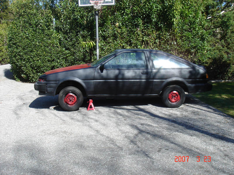

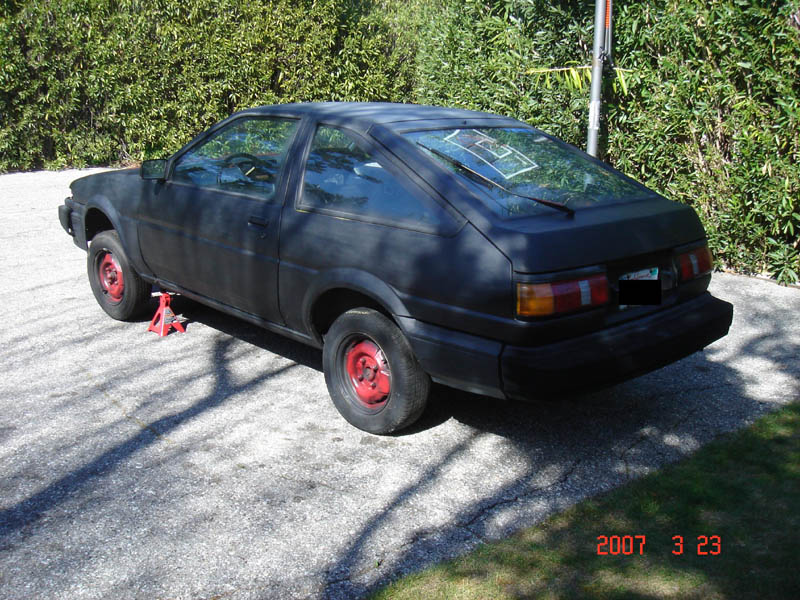

Some pics of the car. Engine pics coming tomorrow.

Thats not a bad deal, looks like a nice bit of work though.
Note that you're missing the water pump pully and mechanical fan, and I don't see an alternator. Probably you can get at least some of these parts from the MR2 if its a 4AG powered AW11. Good excuse also to go for an electrical fan.
Not sure if you could use the total radiator and fan assembly of an AW11, its probably sized differently.
I also do not see an oil cooler, you may need to source those parts or go for a better aftermarket one though that would be overkill Smile
