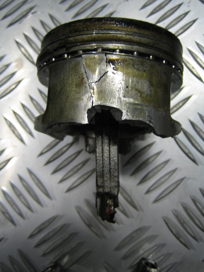

the following pics , at the end of engine taken apart.
As I was thinking , nothing can be reused ,
The worse is that it only had so few km .
Must try to find parts now .
Have a nice year ( mine began bad )
Phil

01-03-2009, 10:45 PM
Engine out
Really strange pics...
I never saw nothing like this and i must tell you i've already saw many broken engines...
However, imho i think you had some lubrification problem...
Keeping the AE86 alive!

01-04-2009, 04:54 PM
Engine out
I'm by no means an expert, but the one thing that looks strangest to me is the piston pin in the broken piston no.4. How is it possible to get this hot enough to go all blue? Huh I'm thinking this has to have gone blue BEFORE the rod broke?
The broken ringland on piston no3 I've seen several times on stock toyota pistons (on different engine models) after mild/medium detonation.
'85 AE86 4AGE, '94 SW20 3SGTE, '83 KP61, 72' RA21
01-04-2009, 07:17 PM
Engine out
for the piston pin , don't know how it's blue . when assembling it piston was heated and pin stay a night in freezer. I didn't do that job myself and may be it was a reused pin ( don't know why as a new piston comes with new axle).
For the break between rings path, I already had that on 2 pistons , and the first time occur with my first break , when timing was totally false .
The pistons brand is Mahle , and not Toyota
