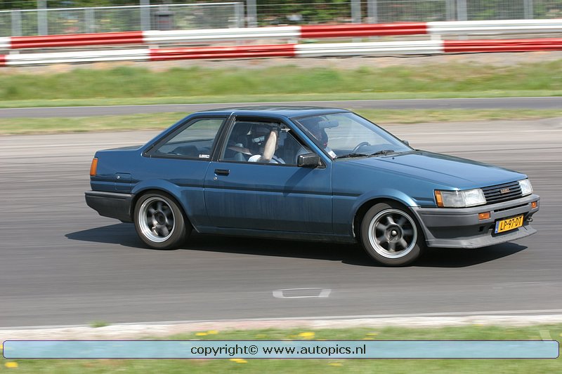

I just hadd a bit of track time last saturday - actually my first Smile What I learned was that rear shocks has to be as hard as possible and you need high tire pressure too. Bushings makes it a lot easier too Wink
I could get it sideways but not that much since this was a first for me and there wasn't too far to the fences.
My setup:
Stock blue top
Poly bushings
TRD 8 / 6 kg/mm springs
TRD dampers
Rebuild stock LSD
Quaife steering rack
Shitty no name tires all around
Before going again I would to get some front tires with more grip and some camber plates. I dont believe that new sway bars is nessesary - yet any ways Wink I could easily play a bit more with tire pressure and damper settings (for grip driving) but thats different story...
