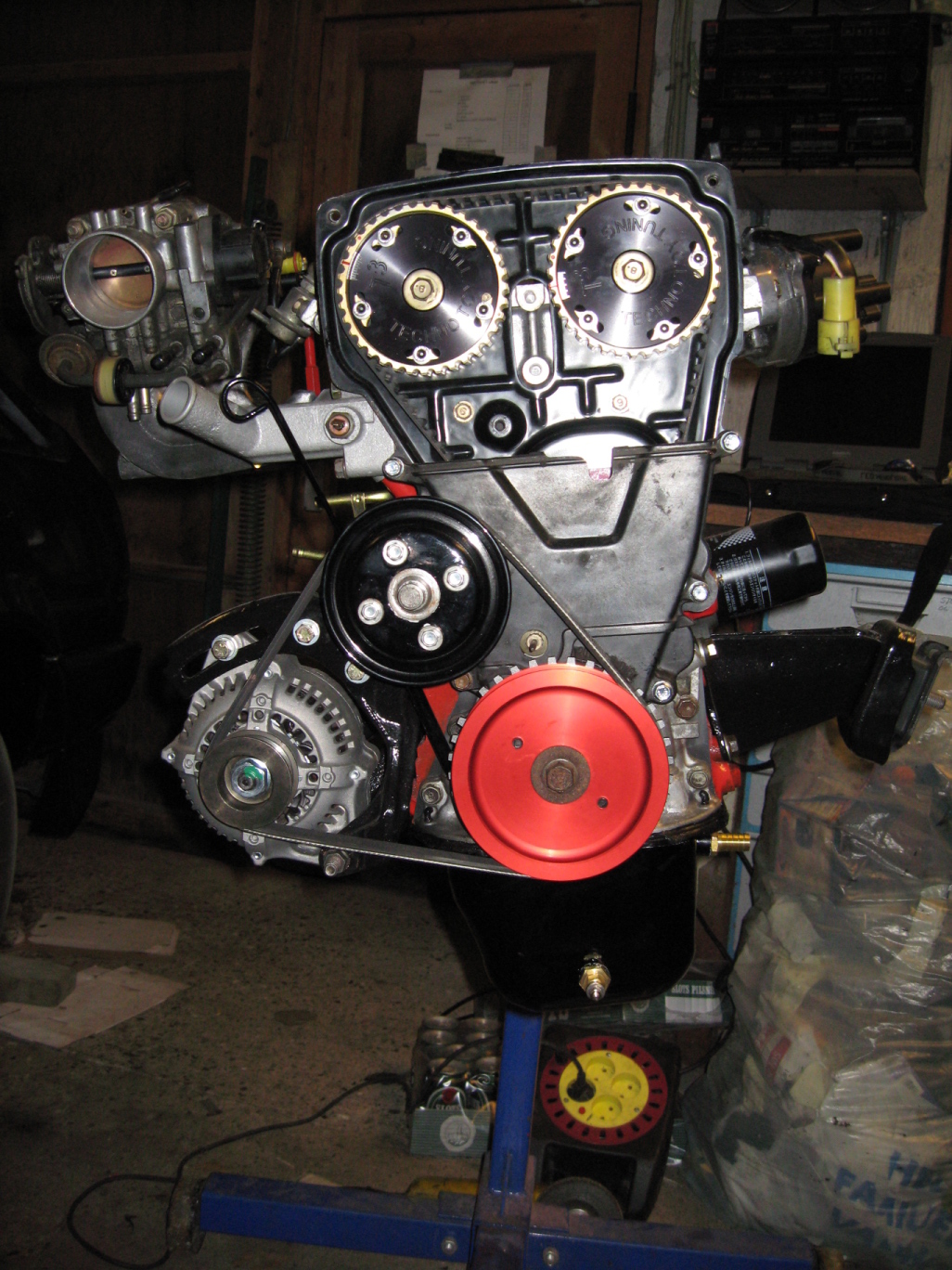

what is for the bolts (gold) on the oil pan?

Hey.
The one of the front of the oil pan, is an oil temperature sensor. Then on the front-side, we have oil return from the oil cooler ( Getting one if needed) and the last one is for oil return from the turbo.
Regards

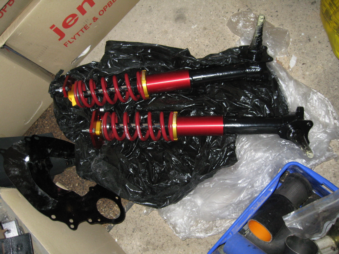

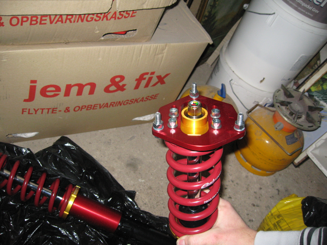

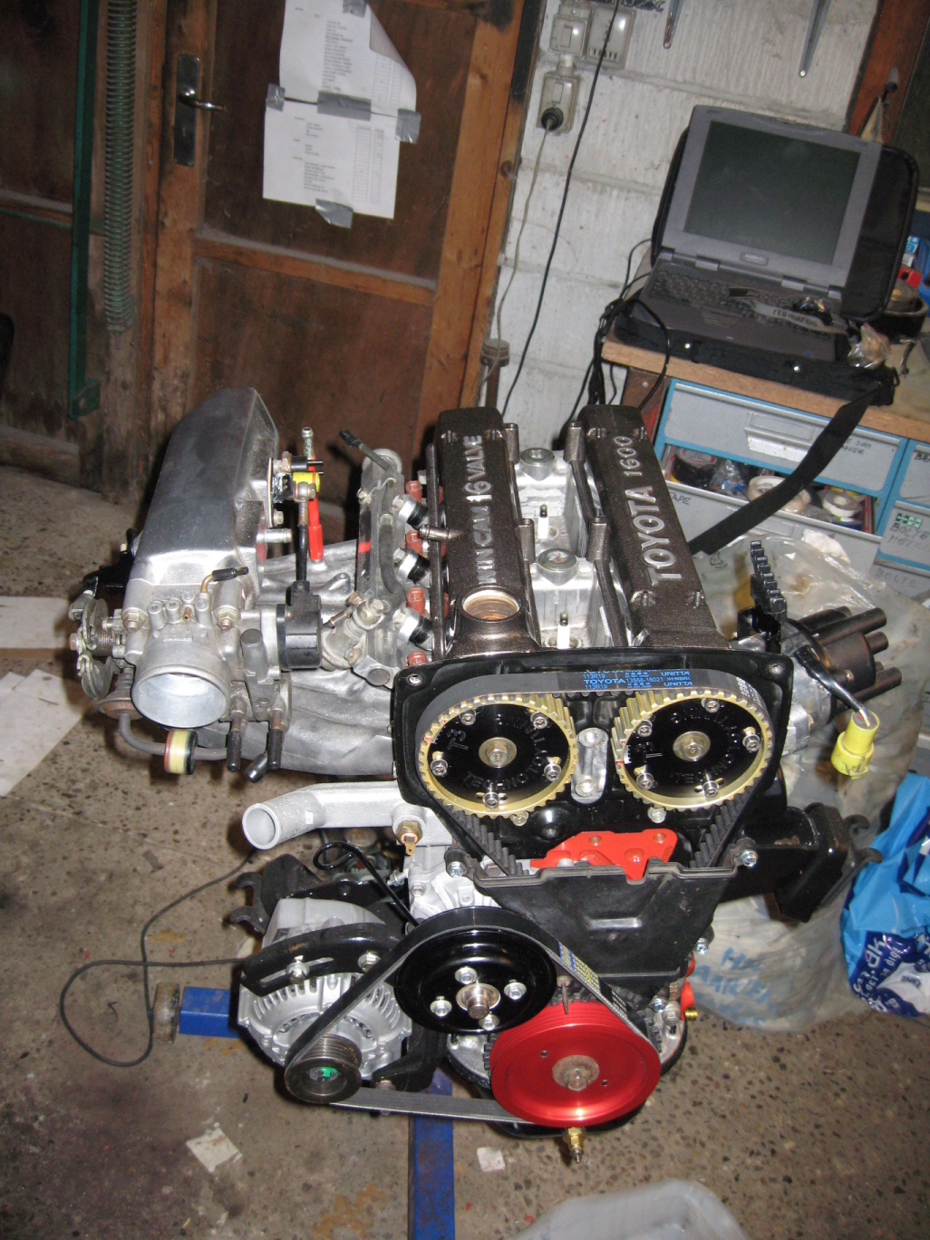

Hello.
I believe it is time for a little Christmas update.
Yesterday I got my birthday and Christmas presents from my girlfriend and myself Smile Just some parts from T3. So what better thing to do on your birthday than installing the new stuff Smile Sadly the cam-timing wheel's were in black although I had ordered them in red. But that has been straightened out with Gabriel, and two red centres are on the way, free of charge, that's really nice costumer service.
I've also installed a remote opening device for the rear hatch. And connected to my alarm. aka. remote "hands-free" opening of the hatch. Thumbs up! (and with the key-cylinder removed quite a necessity).
Here's a couple of shots of the engine and my new camper-plates.
