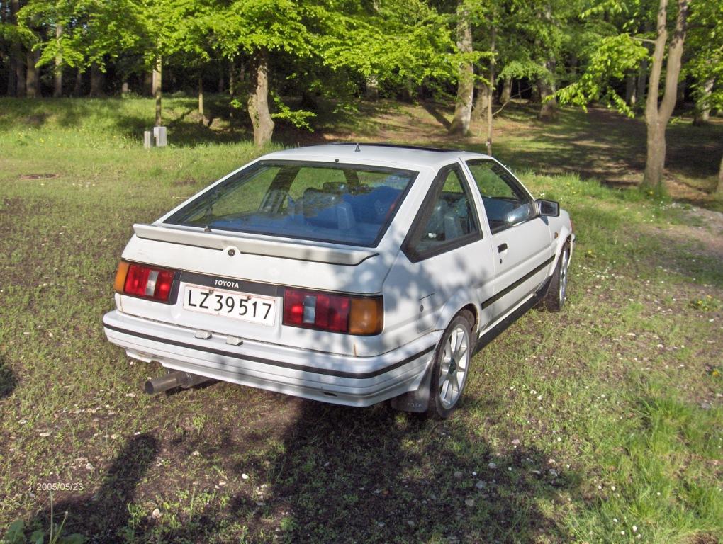

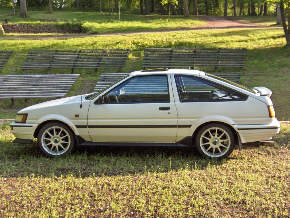

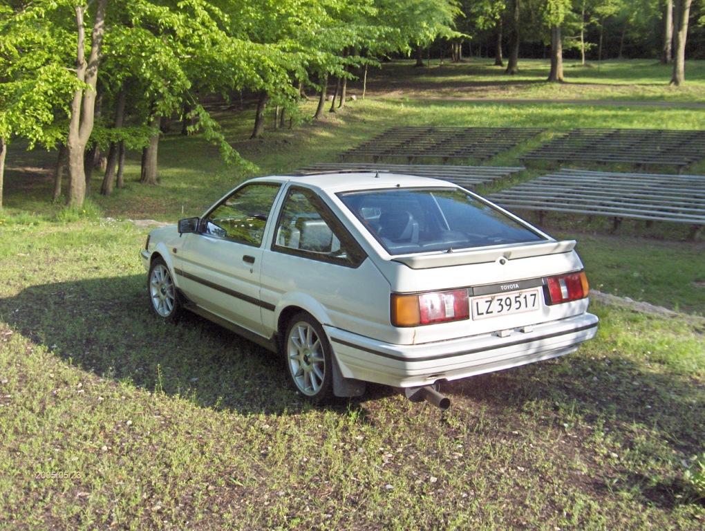

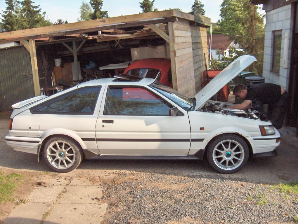

I've seen so many good projects on the forum, that I think it is about time I write a little about my AE86 project.
I bought the car a couple of years ago, from a man in the mid 50's. He had bought it from a guy back in 1988, so I'm the third person to own the car. He had spent alot of time keeping the rust down, but he didn't know about the rear wheel arches, so they are rusted away.
The car has had PAVA (rust protection) every winter he owned it. So I must say it is in pretty good condition.

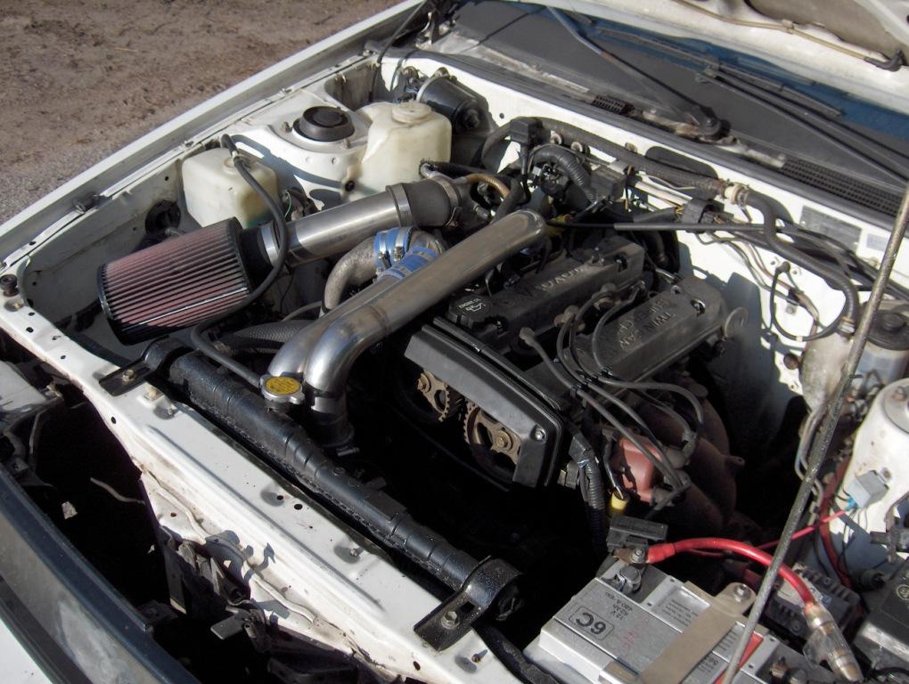

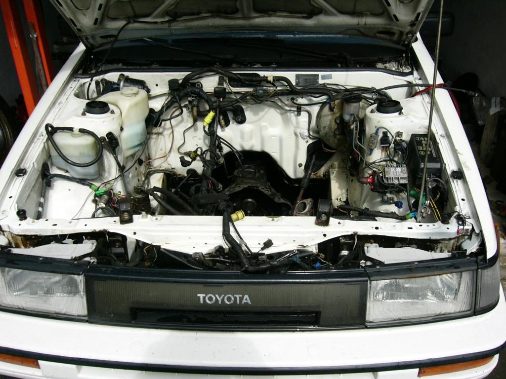

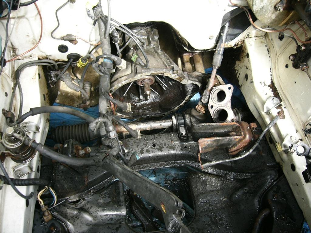

A couple of weeks after i bought the car i blew the headgasket, and i decided to go for something with a little more power, so I went out and bought a supercharged engine imported from Japan (165HP 4AGZE). I've posted some pictures of the procedure below. I used the original enginemanagement system, which i had a tuning guru here in Denmark modify, with some new parts, so it could manage the supercharger, and fuelnozzles(?).
Just recently I've turned in the number plates and cancelled the insurance, so the car has seen it's last winter on the roads.
I'm going to completely rebuild the car, with rust and accessories. Unfortunately it has an aftermarket sunroof, which is pretty leaky, so I'm looking for something that I can install instead. I'm considering installing an original sunroof, or maybe a glassfiber plate.
After i have repaired all the rust, I'm going to have it painted in the original color, with some metallic and a touch / tinge of blue.
I've started buying the stuff I'm going to install in the car when it is MOT-tested OK.

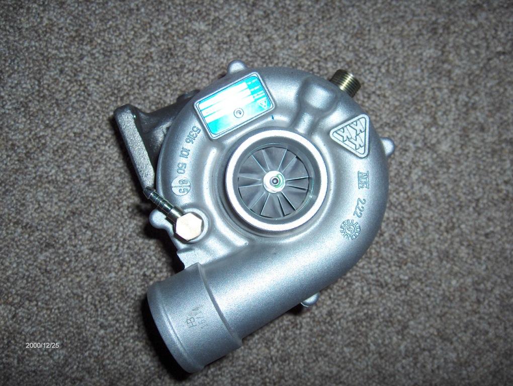

KKK K16 Turbo with 360degrees racing bearing

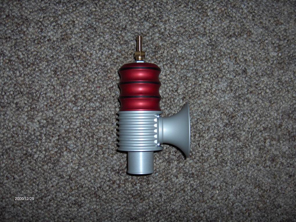

Noname BOV in red

01-08-2006, 12:00 AM
The pictures of the engine swap:
Regards
Lars Veiss, Denmark

I would like to know if anybody have tryed or heard of a 4AGZE with the KKK K16 turbo mounted?

Have you closed the gZe blow-off valve?
[Image: AEU86 AE86 - DK AE86 renovation and turb... driveable] http://www.jdmbits.com
01-08-2006, 05:39 PM
No I haven't closed the GZE blow-off valve. Why should I do that? Actualy, I think I can recall that there isn't fitted a blow-off valve on the GZE, there's no need for it, when using the installed magnetic-coupling.
Regards
Lars Veiss, Denmark
01-08-2006, 08:57 PM
There IS a stock blow off valve in the gZe air-circuit, programmed to open when pressure excides 0,8 bar. This wont let the engine have any problems.
BUT if you use a larger pulley as I do (mine is now working 1,1 bar at 6.000 with 5th gear), this wont let pressure go up.
Anyway, since you 're gonna turbo-it, you re gonna use your own HKS blow off Tongue
