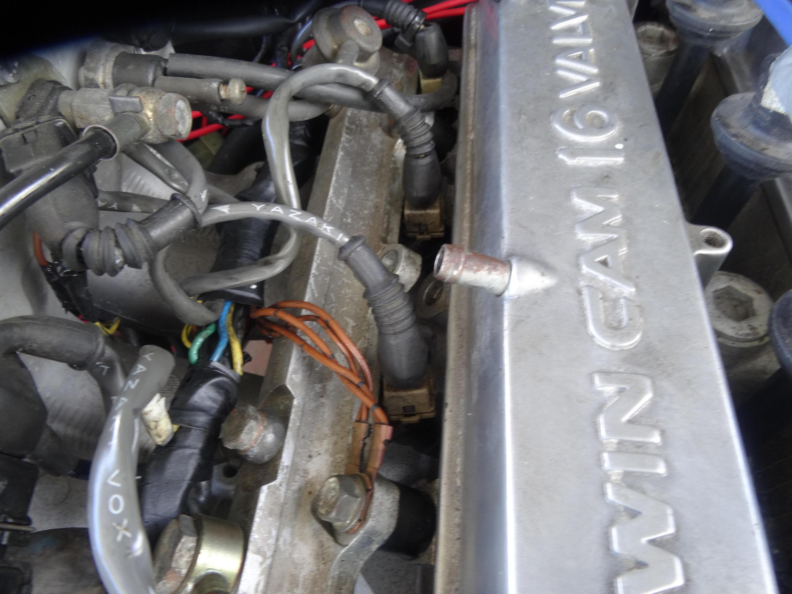

i don't have the breather pipe. it only just started doing this though ive driven the car here and there to run it in for 2 months. i wasn't the one rebuilt the engine could be rings installed wrong way will i need new rings or just pull it out flip the rings the other way? they re fairly new.

Camcovers been blasted and painted, possibly blocked the breather? You getting any pressure from the breatherport on the camcover?
Well if you were to check the rings, heads commes off, new headbolts,... better make sure its nothing else! Is it using oil, too?

kpretro84 Wrote:i don't have the breather pipe.
If you don't have the breather pipe, what do you have ?

yes a jumping dipstick correct. about the breather i have picture

Just try to get the breather working again, would be the easiest thing to do before swapping the engine.
