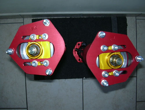

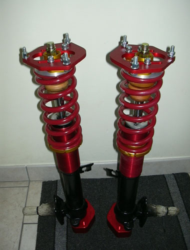

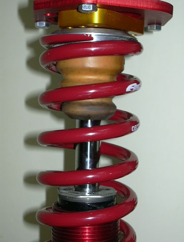

I run T3 camber plates,NRCA, and roller bearings, ground control weld on coilovers and Tokico HTS shocks.
here are some pictures: Smile

Looks real pretty Rikard!

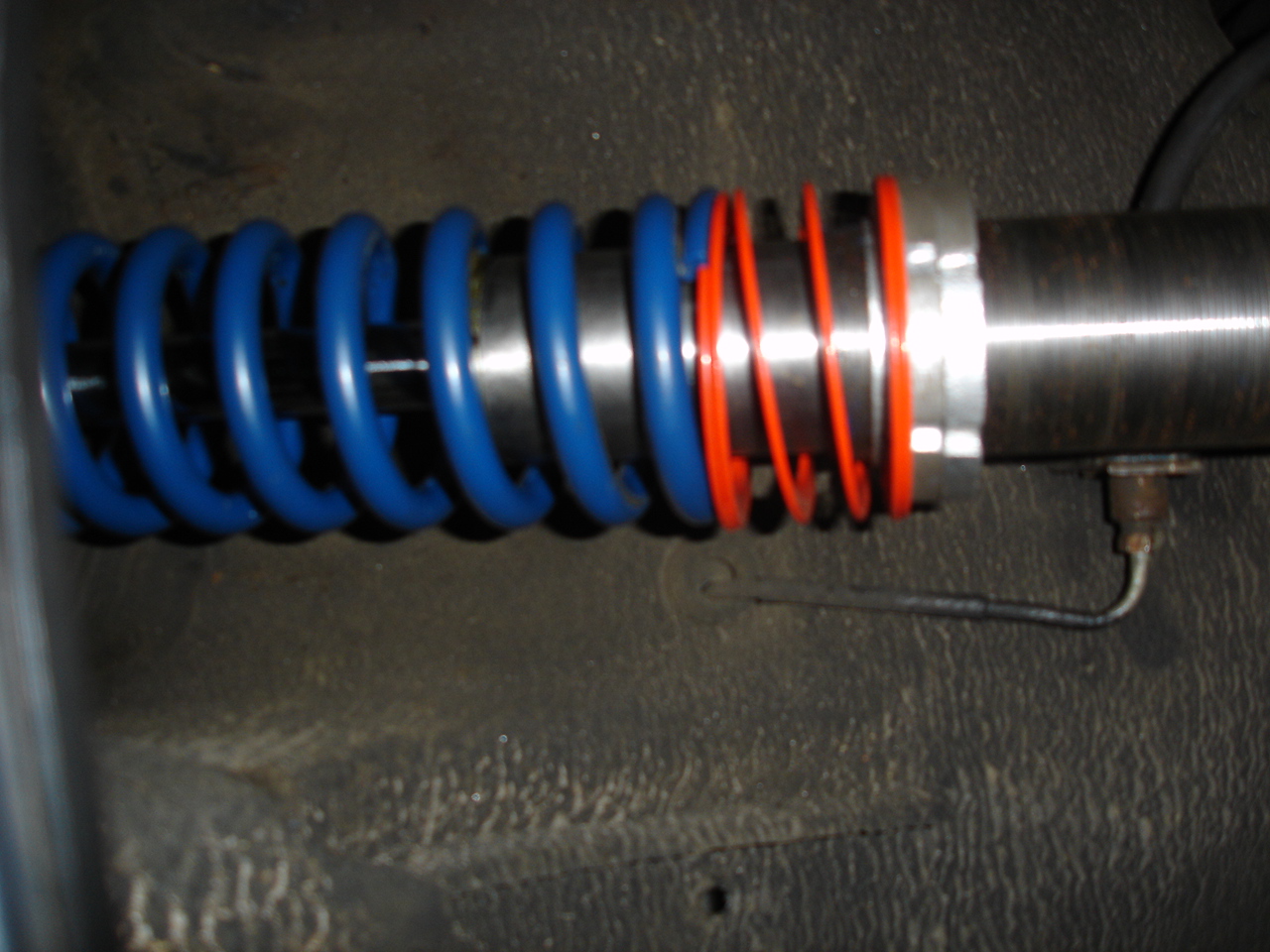

You could do the same as a friend of mine did with his starlet (the crazy guy is swapping a 3S-GTE into a P7!!). Because he had to use Celica T16 struts with T18 hubs (or something like that, it's a hybrid suspension Big Grin) he really needed a coilover thingy in the front.
He placed a "hulpveer" (dunno the english word for it, an extra spring maybe Big Grin), the red one u see in the picture (which i did'nt rotate Tongue)
The red spring doesn't really interefere with the normal spring, but it just keeps the spring in it's place.
