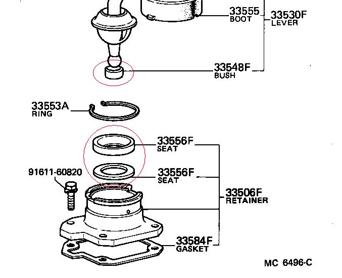

After all these years of use, the t50 tryes to do its job. Usually the 2nd gear has the most comon faultys, and the symptoms are just hard engagement.
When I bought my car, i dindt have big problems while shifting, but i had lots of backlash and play, even when a gear was engaged, the shifter would move around like it was unengaged.
I bought 3 little rubbers at Toyota and the backlash was gone, it became a nice and precise feel on the shifter.
If it helps
Here are the part numbers
33548-14010
33356-14010
33356-14020
If aint this the solution, then got to be something inside, like a syncro fe.

Check the 4 bolts that hold the gear lever onto the gearbox housing, to make sure they're tight and not missing any!
That nylon bush at the bottom of the lever in Lipinhu's post above (p/n 33548-14010 ) can wear or even break up completely, giving a very sloppy feel.
It's worth replacing, anyway, as it's only a few euro.
Warm it up a little, and it'll fit easier. Don't forget the grease.
Do you just get the baulking when you change from 1st to 2nd? What about 3rd to 2nd?
If so, it sounds like a synchro problem.
