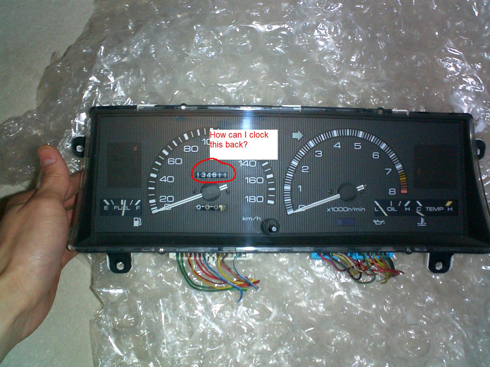

As some of you guys may or may not know, I am preparing my car for a digital to analog gauge cluster swap. But I have a question which I hope some of you guys can help with.
Basically I want to be able to change the reading on the mileometer so that it matches the cluster gauge that I will be taking out. I tried already but stopped because I didnt want to break anything.
Any tips would be helpful!

Carefully dissasemble and adjust. Try not to break something.

Hi Zax
Thanks for your post. I have taken the whole thing apart, but don't know where to go from there. Does it involve taking the 2 screws and the needle off? Can you just roll it back afterwards?
If I take the needle off, will I need to get the speedo callibrated afterwards?

I belive that you can disassamble the roll, and then put the numbers back in the "right" order.
You need to take off the needle, its easiest done with a regular fork - just put it under the needle and gently pull it of. On the back of the mileometer theres sort of a cup in metal, where the cabel turns. If you mark the needles position proportional to the cup, the mileometer is still correct. In case its not, it pretty easy to calibrate. Just hold on to the cup, and turn the needle back or forth ex. 20 miles (if it shows 20 miles to much)
I did it on my previous Toyota, and as far as i know, it still works. Thumbs up!

Be careful taking apart your "clock" They are not designed to be disassembled, but they can be taken apart, I know for a fact. Just take your time. You can however keep rolling it forward until you come back around to the right number, but It could take a long time

No probs. I will take pictures and maybe write a how to. I will probs do the same when I am swapping the gauges over too, so just keep posted.
