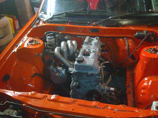

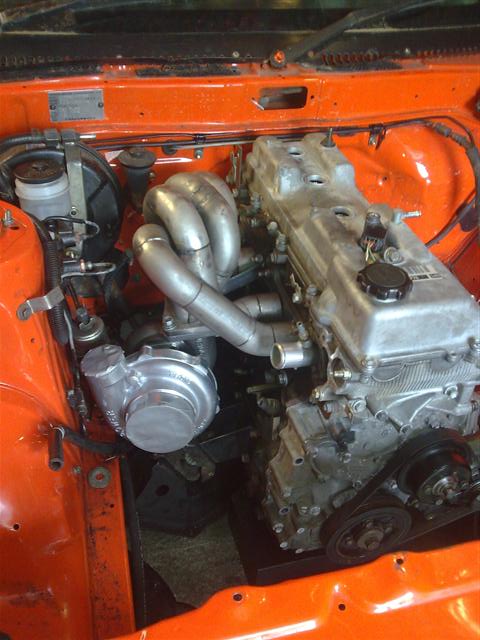

How much clearance do you have now? about 5 cm?

yeah formt eh close point of the sterring rack to the botom of the oil pan is yeah about 5mm- still have about 10-15mm from the oil filer cap to the bonnet so stil all good there.

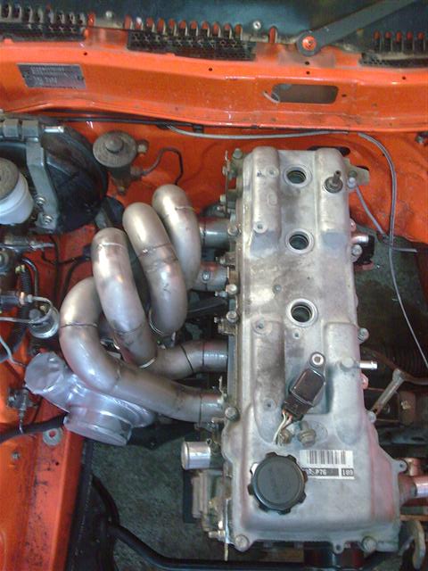

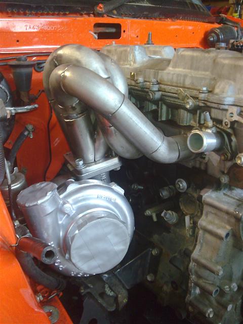

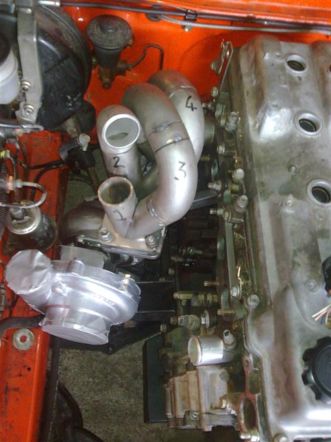

Day one of manifold construction....
3RZFTE TA63 Carina
http://www.youtube.com/watch?v=Rkk_2-dl7GE
11-10-2009, 11:01 AM
Carina stage 3!!
Exhaust mani is looking mint! Sweet sized turbo too.
Just got back from holiday last night, have been thinking more about plenum design, got it sorted I reckon! With a bit of tweaking will have the drawings for it finished over next few nights.
Drawing it is easy, I think your friend is gonna have a heart attack when he goes to CNC it Evil

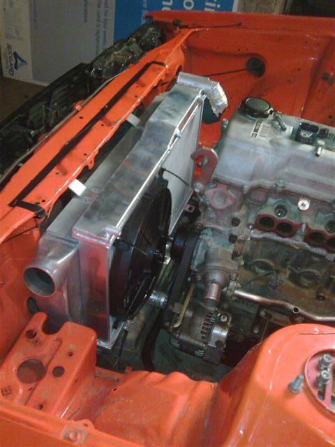

Couple things happening at the moment- picked up new radiator and a second hand greddy tube and fin intercooler, currently mounting them.
ran out of materials to finish the turbo header so will grab some more next week and finish that off when i get motivated.[/code]

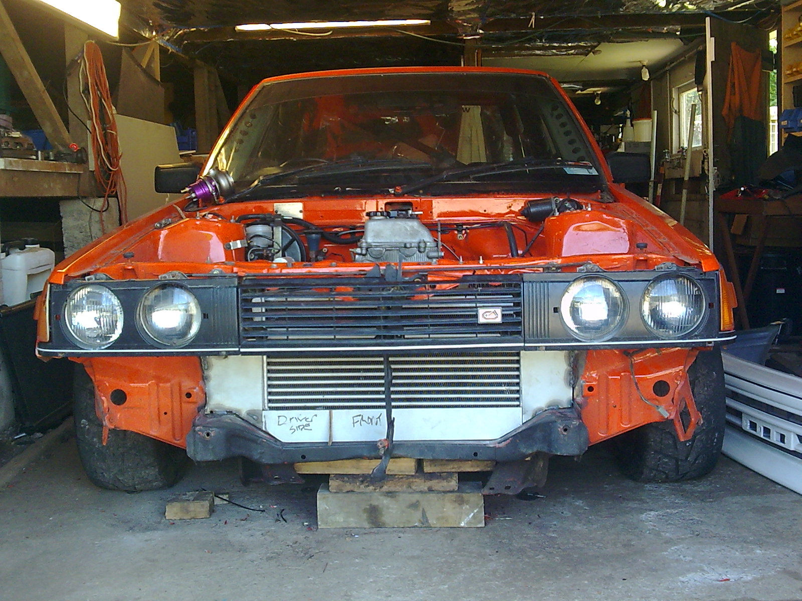

Oh yeah - finally dummy fitted my twin round lights- me love them long time

Lights look awesome!

Round headlights! Thumbs up!
Personally I prefer the quad square headlights, but the round ones look great on your car! Thumbs up!

cheers- if you happen to find a set of rounds- il swap ya for the two sets of quad squares!
