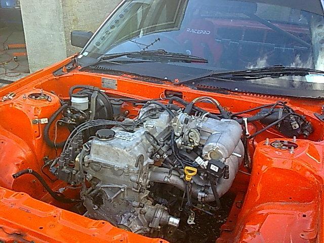

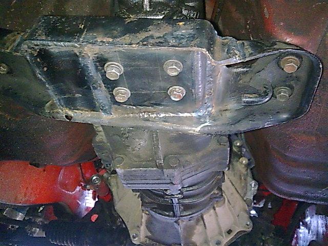

early days on the 3rz conversion right now having only just finished the engine and transmission mounts today and mocking up the custom sump.
improvements to the 150hp commercial engine planned include a decently sized turbo- head work- custom inlet with 4age quad throttle bodies- remove the balance shafts- aftermarket pistons and connecting rods- MS3 engine management, just to name a few.

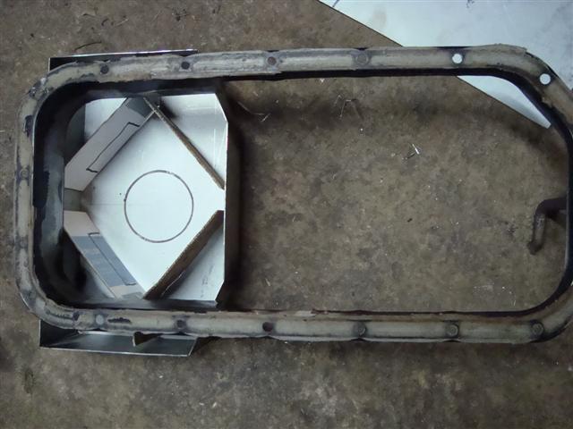

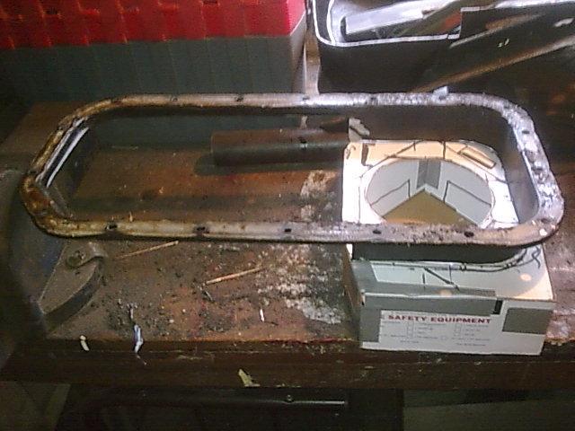

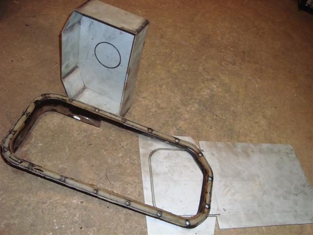

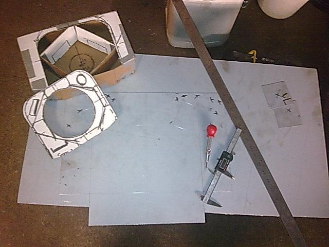

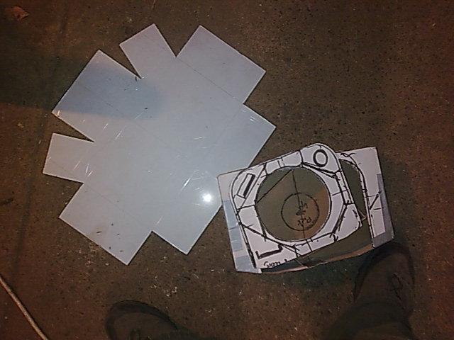

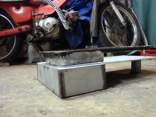

Got started on the oil pan tonight- probably the hardest thing about this conversion that ill be doin. (dont want to have oiling issue and run a bearing like the v8 did!

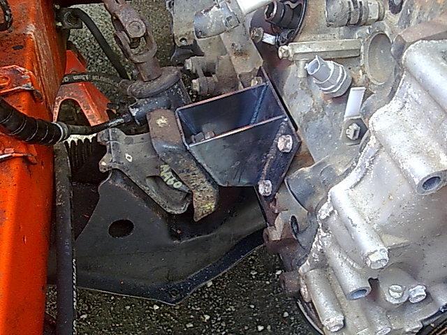

bit a of waste of a day today- trying to get the oil pan shape right to clear the steering rack and not hit the connecting rods- after about 6hours of refusing to admit it- ive mounted the engine too freakin low in the bay!
so tomoros mission will be to remake the engine mounts with the engine 10-20mm higher dammit.

Ill put the last days effort down to experience Confused
Engine to come out in the morning- ill finish the new oil pan and remake the engine mounts breinging me back to square one.
