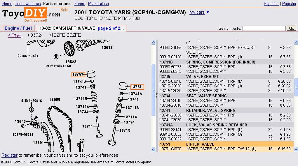

I have a problem (not a first time)
Toda ll late the order for 1 /12 month.
Maybe i ll cancel the order and buy the lifter of yaris
http://www.toyodiy.com/parts/p_E_2001_TO...302.3.html

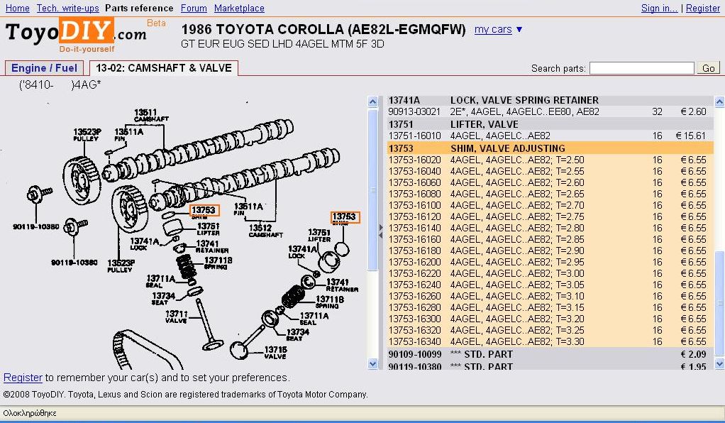

The differents 1szfe and 4age. The 4age has shims too but 1szfe not have. What happen with the shims?

I believe it works like this
The lifters in a 4age are seperate to the shim, eg 2 pieces.
Where as the 1szfe lifter is thicker then 4age and is all in 1.
4age has 1 lifter size but different shim thickness, and 1szfe has different lifter thickness's, getting rid of the shim.
For the 1szfe im not sure what teh (j) and (l) are for?
