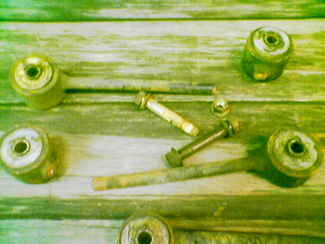

Okay... It was not a broken LSD. Confused
It turned out two of the links were broken. Sad

WOW Huh that is some serious stuff man!I don`t want to imagine what would happen if the other 2 would also break!

What is that stuff where the bushings are supposed to be? I thought you had pillow-ball 4-links under that trueno but this looks more like steel bushings.
If i remember correctly Mux still had some of these links from his spare axle.. I think I might have one from nohachi's old celica axle in the basement as well but that's not going to help much is it.

wouter86 Wrote:WOW Huh that is some serious stuff man!I don`t want to imagine what would happen if the other 2 would also break!
How could this happen?Extreme speed over bumps or something?Maybe wrong installation of the links?
Bizarre thing is I didn't drove wild / extreme etc with the car, while TE71Corolla threw it into every corner he could find. It just broke while speeding away after parking the car (second one) and after stopping for an old lady to cross the road (first one). Huh
All four links are tailor made, so they are thinner (to save weight?) and probably weaker. They used to be under Kees's car and after that TE71Corolla mounted them under mine. So I guess it's just age which caused it. Wink
Lucky enough I drove very carefully after it happened, so hopefully no damage to the axle and prop. Smile
Ivan141 Wrote:DAMN Huh Huh
Nylon bushing. Wink
And they are already swapped. Smile

HOLY SMOKES!! Never ever seen this happen before and ive even saw some rust bucket ae86s fromthe UK that this have never happened to.....lucky for u u were only cruisin about and not mid drift at 60-70mph as u really wud have known all about it!!! Huh
get some spherical jointed links dude. much lighter than the std shite and makes the rear end extra tight! like what the panhard rod does.....in fact..CHECK THAT OUT TOO ON UR CAR!!! make sure its not some pencil ass tailer made shit to save 1Ib. remember, tailers make and fix suits for people...not rear links for 86's! :wink:

Ian - AE86 Wrote:HOLY SMOKES!! Never ever seen this happen before and ive even saw some rust bucket ae86s fromthe UK that this have never happened to.....lucky for u u were only cruisin about and not mid drift at 60-70mph as u really wud have known all about it!!! Huh
Believe me: these links have proved their right for existence. Wink
Breaking one would put all the stress on the other links, so it's quite logical for the other to break shortly after the first.
But I'm not aiming to make my car a mean drift machine, it's a daily beater. Stock links would suit such purpose fine. Wink
