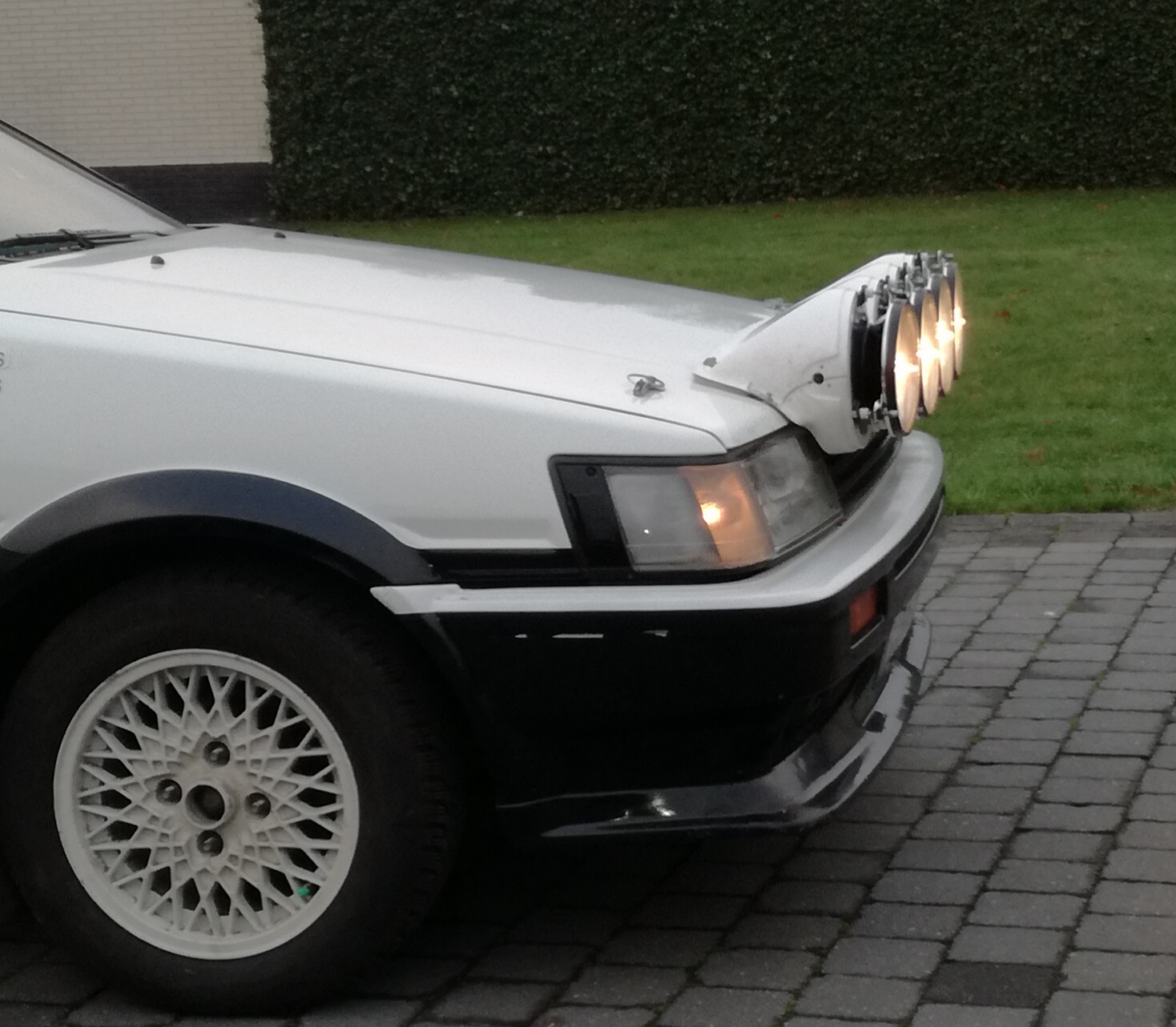

Bonnet lamp pod for AE86
Lamp pods for AE86 are difficult / impossible to find (for me at least
). So in case some one has plans to install one someday here is my setup.Pod is original from Renault 5 GT Turbo and it's as good as plug & shine . As you can see, the angle at the back is a bit off but using DZUS slide latch makes it fit firmly and it can be installed/removed in a few seconds I attached two staybars to the bumper with quick connection to reduce vibration but it wasn't too bad without also. |
