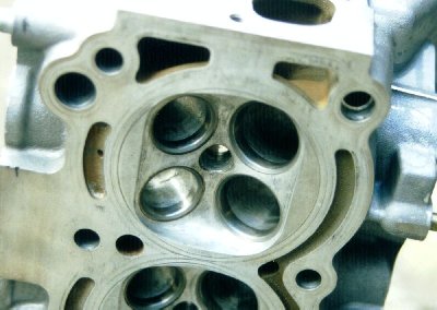

A few weeks back I did a bit of porting... MILD porting!. Here is the work I just did....
Raw, unworked ports on left........................................................ blended ports on the right ![]() ![]() ![]() ![]() Now besides cleaning and blending around the valve seat, the exhaust ports are usually rather rough. Here again, blending is the call. This time finished ports are below raw ones ![]() ![]() ![]() ![]() Finally, for a street port, blending and doing mild shaping to the exhaust port as it approaches the manifold. Not BIGGER, but shped to allow the flow out as easy a path as possible ![]() ![]() The above photos are of one exhaust port, each view focuses on one valve. *IF* you are unsure of what to do... doing nothing is superior to a bad porting job Dan - You can | OST Porting service - http://hachiroku.net/forums/showthread.php?t=19991 |

OST - I have basically done the same as your self with a spare head, mainly just for the sake of experience more than anything else. Would post some photo's but I am struggling taking them with my Iphone.
I have focused on the bowls and cleaned up / smoothed the various lips etc. I have also run down the ports cleaned up the casting marks and applied the appropriate finish to the ports. Out of interested have you noticed depressed areas in the ports just before the valve (seems to be more prominent on the intake side)? Just wondering if this has an effect or if removing the various sharp edges and excess material and smoothing the bowl out will be suffcient and aid flow? ![]() http://www.eight-six.co.uk - read the blog! UK AE86 Forum - http://www.phpbber.com/phpbb/index.php?m...ghtsixcouk |

eight-six Wrote:Out of interested have you noticed depressed areas in the ports just before the valve (seems to be more prominent on the intake side)? Actually what I believe you are talking about is a ridge that is created because the valve seat isn't perfectly centered. The valve seat needs to be ground so the seat and port wall do not have a ridge. When doing streetport work... remember flow direction, some ugly things need more work than others Dan - You can | OST Porting service - http://hachiroku.net/forums/showthread.php?t=19991 |

![]() Hopefully this explains it all example #1) this is an intake port. As such the red area is the REALLY bad area because it restricts flow into the cylinder. The yellow area isn't as significant, but a proper streetport blends the entire area. example #2) this is now an exhaust port as such the yellow area is the really bad area, because it restricts flow out of the cylinder. the red area isn't as significant, but a proper streetport blends the entire area Dan - You can | OST Porting service - http://hachiroku.net/forums/showthread.php?t=19991 |
