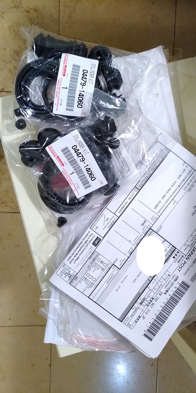

Fast forward almost another year. Last year I replaced both dust covers for the brake calipers and the right hand side turned out to be ill fitted. I already had great difficulty to fit the dust cover on the right hand side and it appears it's just one or two millimeter too large. It started to leak and I decided to get an official brake repair kit from Toyota as Toyota doesn't sell the dust cover separately.
My Toyota dealer charged 82 euros for a brake caliper repair kit and told me on the phone in September 2021 it contains a full set for a single caliper, including the dust cover, seal and both boots. That meant I had to pay 164 euros to repair both calipers properly. I obviously declined when the unofficial dust cover (including seal) only costs 8 euros. Banging head
So instead I got two sets from Japan via Megazip for 72 euros excluding taxes. Including taxes I paid a little over the 82 euros charged by the Toyota dealer. It got shipped from Japan, but the package ended up to be sent to Miami:
[Image: AEU86 AE86 - RE: Banpei's new TA60 family cruiser]
Megazip admitted it was their fault and ordered two new sets and finally after waiting for more than two months they arrived in December:
It turned out to be a brake caliper repair kit actually has boots, seals and dust covers for both calipers. Banging head
Due to all sorts of reasons I only got the time to replace the leaky one last Friday. Due to time constrains I didn't have the time to replace the boots yet, but I'll do that next time I'll work on the car. At least I have progress now and hopefully will pass MOT this month.
