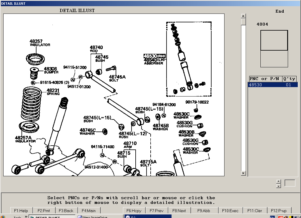

Think I found the answer. Hurray!
Both the AE86 and TA60 have 48530 and 48540 as partnumber for the rear shock absorbers, only the TA60 has different mounting points. Smile

are the whole partnumbers the same?
Because that first number says nothing more then: it's a shock Tongue
Even my Starlet rear shocks do have those numbers, it's the number after the dash that counts!

Double checked: they are different in numbers. Undecided
However... The front shocks differ in numbers as well, so we won't know till I've put them under the carina. Wink
