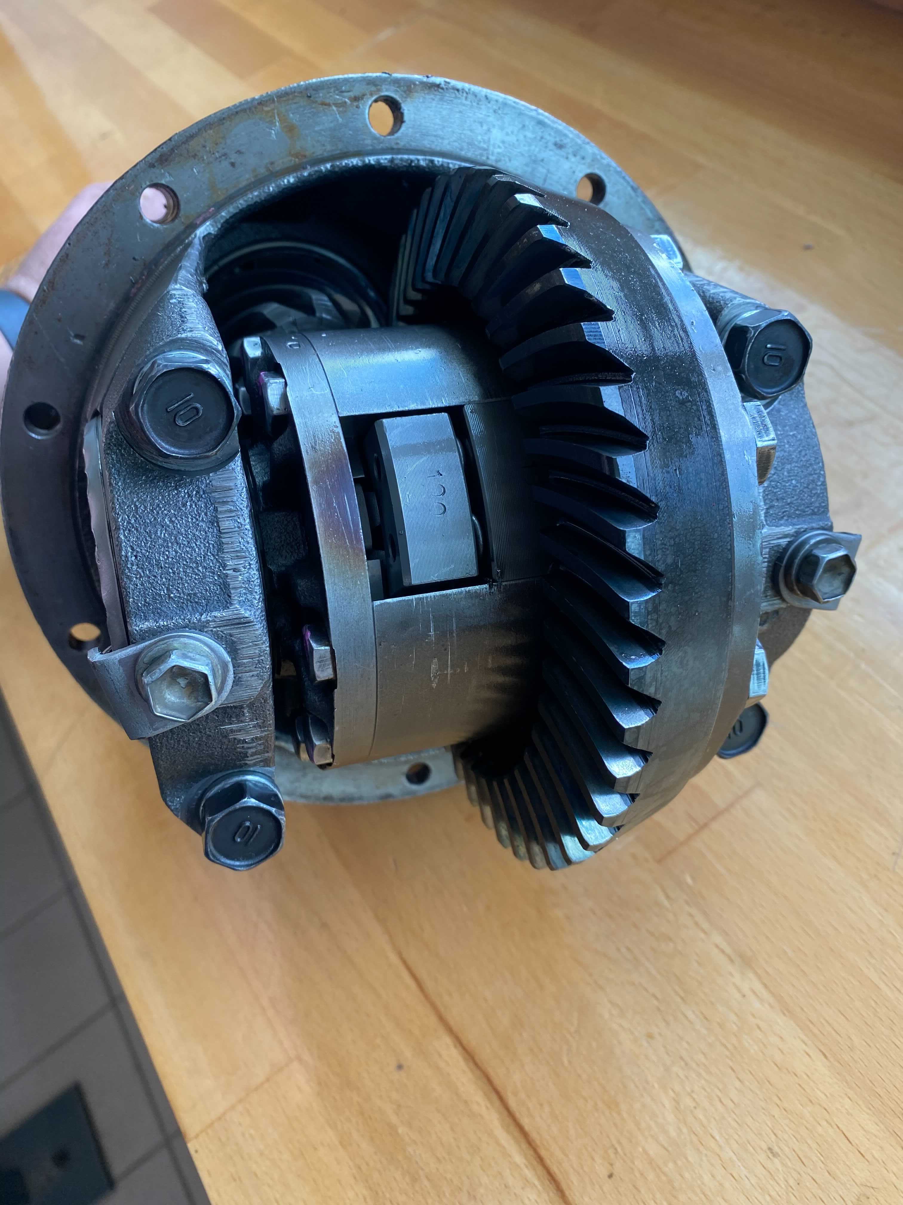

Anyone recognise this diff?
05-05-2021, 12:54 PM
Before I have it in a million bits on my bench to inspect it does anyone recognise what diff this is and any manuals for it?
05-05-2021, 01:16 PM
Are there any other markings?
Try to take more pictures and turn the diff to see other identifying factors.
AE86 ex-daily
05-05-2021, 09:29 PM (This post was last modified: 05-05-2021 09:31 PM by Ivan141.)
My first guess is that is an OEM ae86 LSD, not (yet) broken. You usually get teeth marks on that clutch plate in the middle once it breaks.
There are awesome vids of some japanese guy rebuilding an OEM diff on Youtube, I think Banpei may have had a link to those up on the front page at some time in the past.
05-05-2021, 11:03 PM
Looks exactly like my oem zenki lsd.
ハチロク
[Image: AEU86 AE86 - Anyone recognise this diff?]
05-06-2021, 02:54 PM
Thanks guys, yes it was the OEM LSD I found the manual and she looks pretty good inside.
