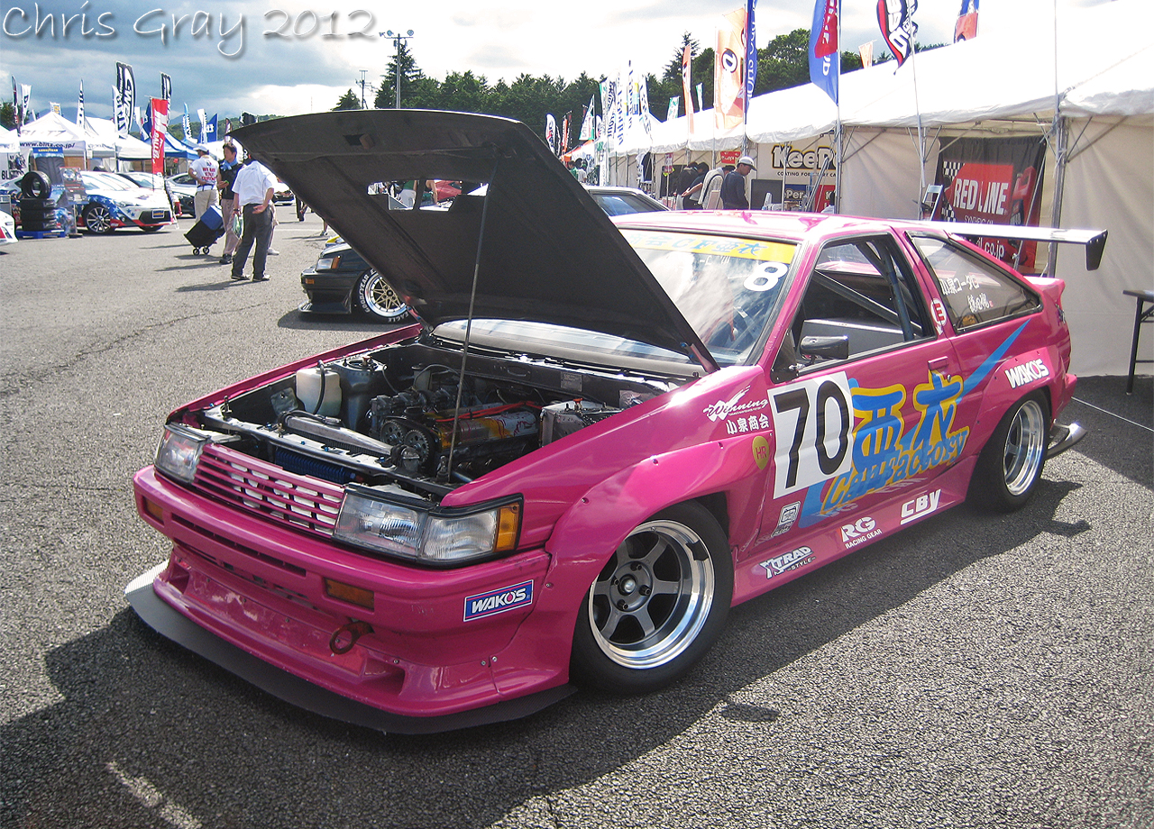

On the Car Factory N2 AE86 They use 9.5J -20 all around (with 10mm spacers I think) OEM rear axle and TRD fender.
They are available in 10J -25 (~18mm wider than the 9.5J -20) so that should be wide enough.
For the turbo setup -> The DMAC 86 with 13B turbo (supposed to be 500hp, but I think it's lower than that) still have the OEM rear axle with Weir big axles kit.
