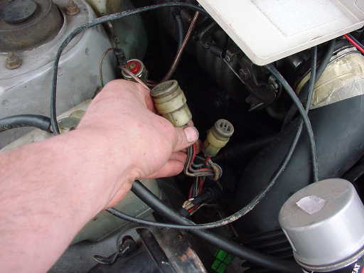

Now only the back up lights, I think i'm missing the cable between the lights and the gearbox. And a picture of the suspected cable.

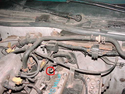

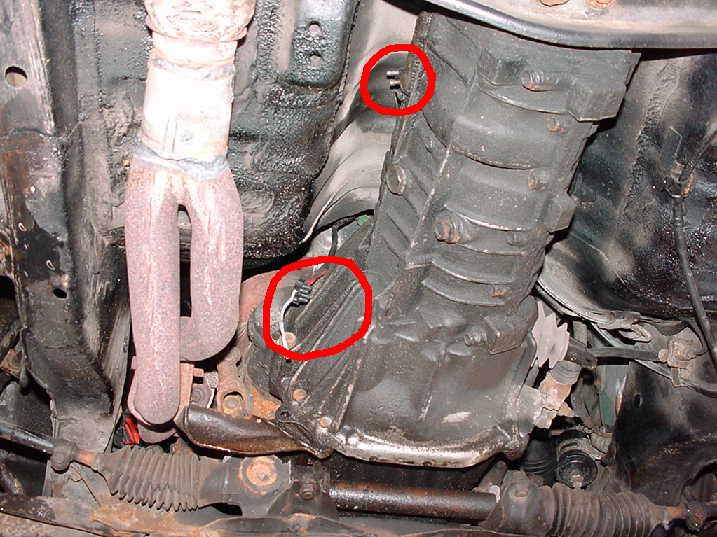

cj, I made some pictures of the sensor. It's located under the car on the left side of the gearbox (small part).
I'm glad that I managed the lighting so I can travel tomorrow to the RDW to get a registration for the car.
The cables are original red with a black line in it. Succes CJ! Thumbs up!
The red cable is found if you follow the engine wires. The engine wires run from near the vacuummeter
