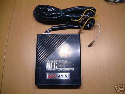

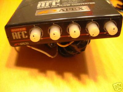

I have find a pretty cheap 1st gen APEXi SAFC (under 100 euros) and I like this device so much Confused Confused Big Grin
What do you guys think? No Hachi?????

Get the Super Air Fuel Regulator wired up and then drive around with a WBO2 and a laptop connected to make it work right.
Only difference with your words is that I was not planning to get a permanent WBO2 but just use one when data login the car...
