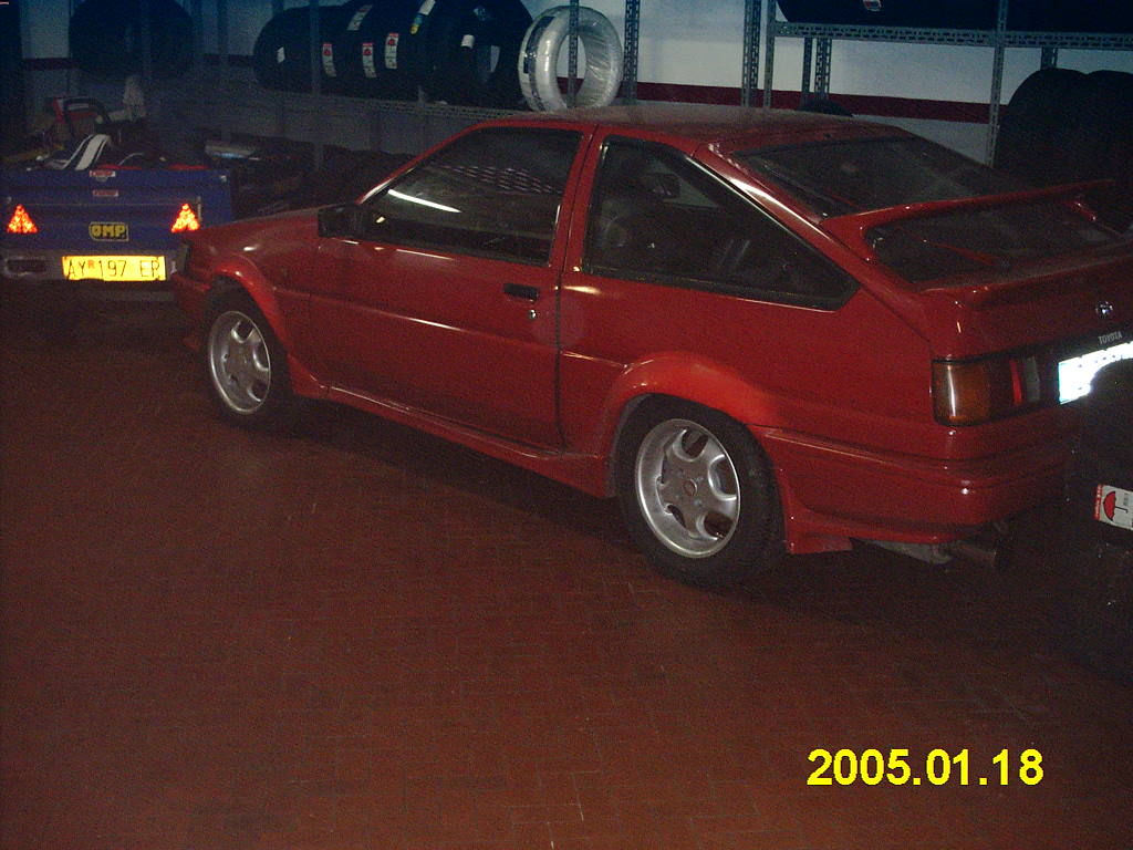

Nice car dude! welcome to the forum! Not to sure about that twin rear wing setup though.. not my thing, but love the color of your car!

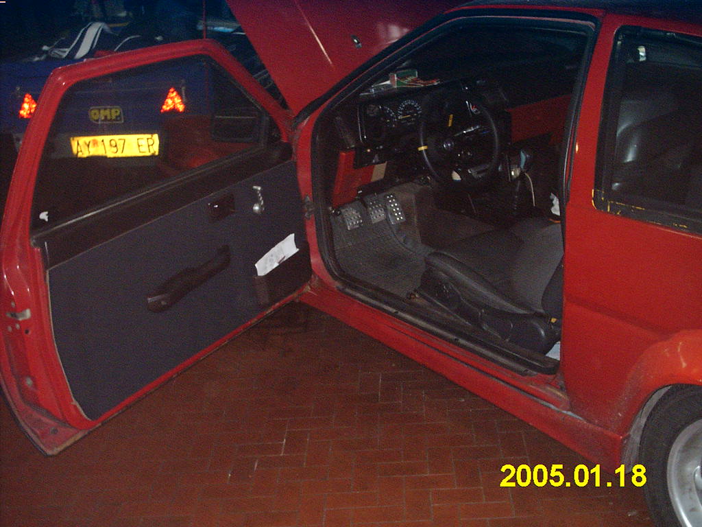

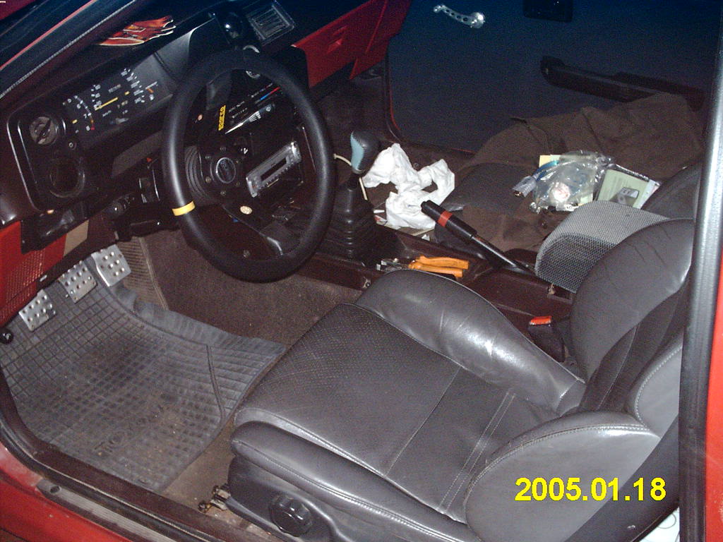

Have you got some better picture's of your seats? I'm kind-of interested what they look like..
03-11-2005, 03:06 PM
AE86's in Bulgaria
Ivan141 Wrote:Have you got some better picture's of your seats? I'm kind-of interested what they look like..
well, I really could not find a good picture of the seats, but here are 2, which hopefully will give you an idea...
