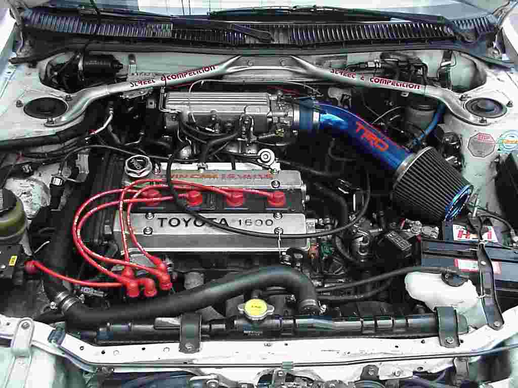

Ivan141 Wrote:Yes we did have redtops here...just not a lot since they only came in late model AE92 gti's. You cant tell just by looking at the head in a picture...not when it's painted.
If you mean this one:
[Image: AEU86 AE86 - AE86 in Croatia]
That's not a redtop, it's just an 120 bhp version.

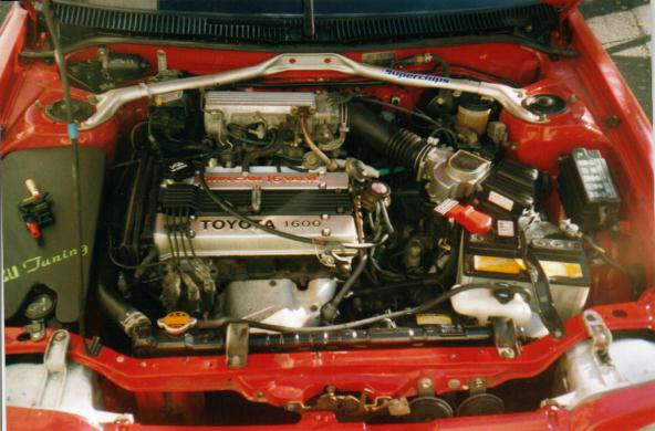

The only one which should be a redtop is this one:
The big difference is the plastic plate above the sparkplugs (that's were i looked for in the picture from Jeroen's Coupe).
At least, this is what i've been told by some Toyota authorities, don't pin me on this.

2 doctor: plastic cover over the spark plugs is just that, plastic that can be changed.
Big difference in red port engine is
a) big port TVIS variant
b) small port no TVIS.
http://home.clear.net.nz/pages/phil.brad...%20RWD.htm
So if you look at Induction & Head, there is only one small port no tvis 7 rib, all others are ITB or Big port + tvis.
Another thing is that i have no AFM, but MAP sensor. So everthing comes in place. No mater the spark plugs cover.
Another thing, don't look the colour of cam covers, on the second picture somebody was playing with colors "TOYOTA 1600" letters always come in black paint, only "Twin Cam 16 Valve" letters change colours (black + blue, black + red, only red).
