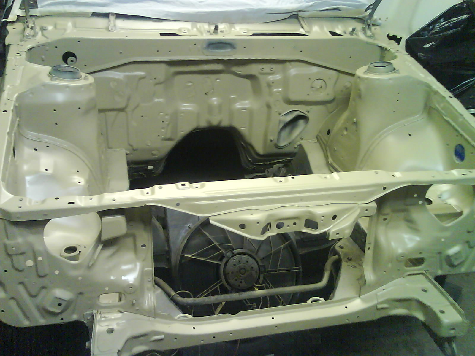

Hey here comes some pics of my process. Big Grin
Soon i will paint the engine and then i will put everything back. Big Grin

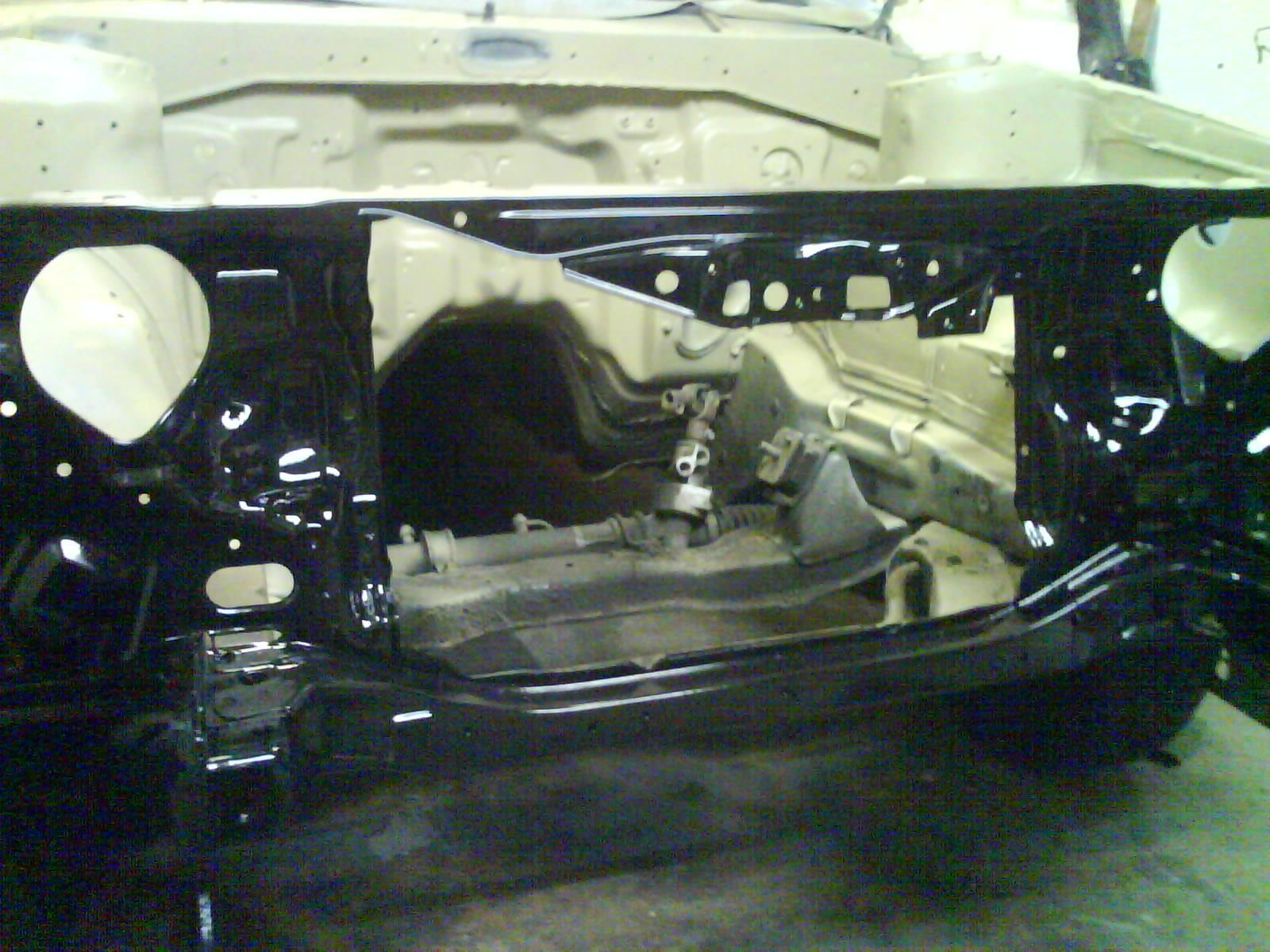

Im done with the spraying Tongue im happy it got very well. And my lovely girlfriend helped me out alot. She said it was fun as hell Tongue

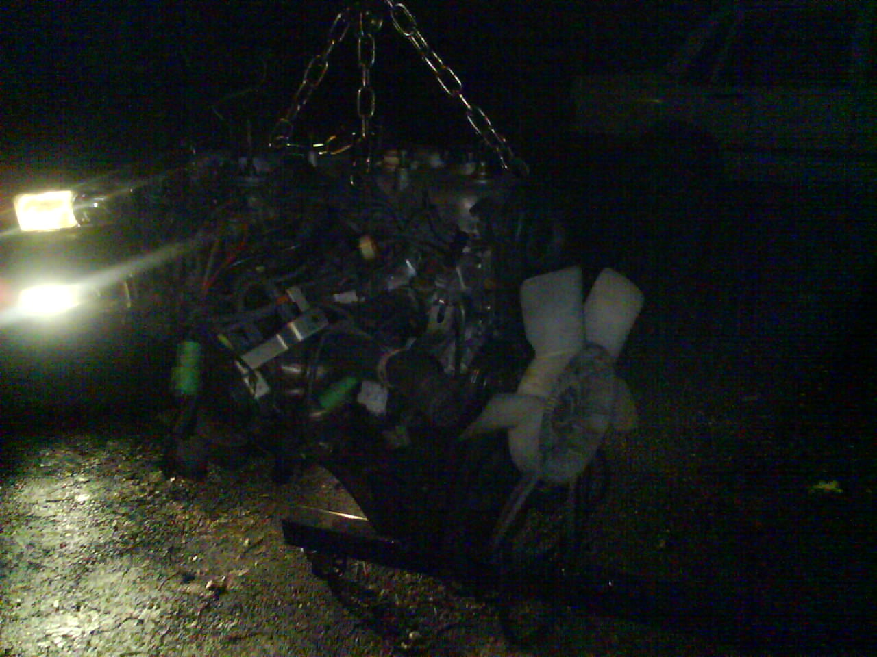

Heres a pic of when i took out my engine w a friend like a month ago . It was his first time to tuch an engine in this way Tongue
