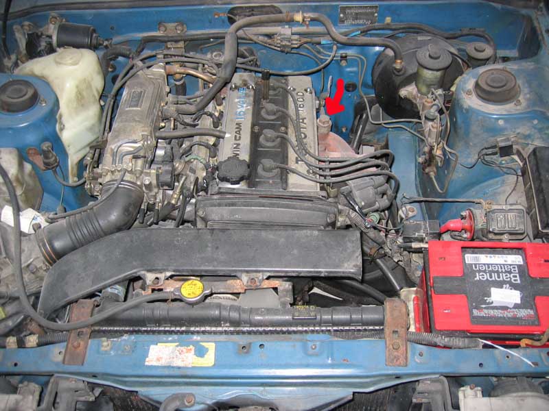

Just wondering:
My car has a screw in one pipe of the exhaust manifold (is this o2 sensor? ), as seen on the picture.
Does this tell that my car should have also the catalytic converter?
I'm asking this because I've bought the car with changed exhaust pipes and I'd like to avoid problems when doing every year's a MOT test.

@Dreja:
That plug is not supposed to be there on most european models I think. It looks like there was an EGR pipe connected to it before.
I'm pretty sure that the O2 sensor usually sits lower on the downpipe because it would only measure the A/F ratio of one cilinder if it's that high on the manifold.

@dreja
that bolt attaches a heatshield over the top of the manifold, nothing to do with oxygen sensors.
edit> nope, wrong i'll look more closely next time

Ehmm...that huge bolt there is certainly not for the heatshield..
The position of it looks exactly like the mounting point of the EGR pipe on the manifold of an AE92 4AGE manifold. The bolt is about as big as the oil drain plug.

The bolt isn't for heatsheld, there is a metal tube going from under the bolt to intake manifold. It should be EGR system, like Ivan said...
I've checked in Toyota EPC program, that my car didn't came with catalytic converter, because it was for swiss & sweden market. If it were for the german market, there will be also a cat. converter...
