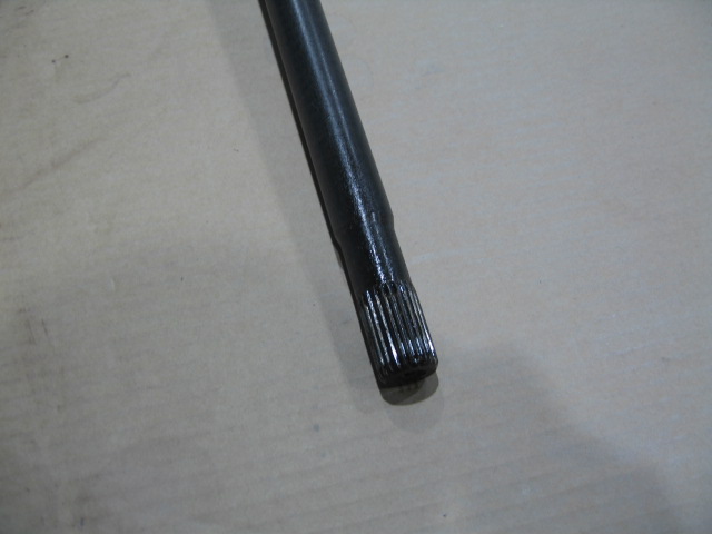

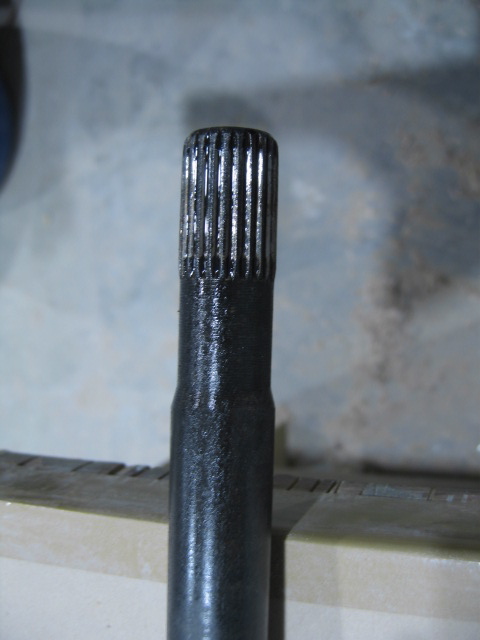

Here are some pics of an axle i removed tonight. From the information I have found so far it seems it is a facelift model.

I know that kouki and zenki axels are diferent, so when fitting a new diff you must keep in mind wicth one you choose. But just by lookink I cant really tell the diferences.
I´ve seen too many people fit in a new diff and never heard about modifying anithing at all.

In my case my model is kouki but the axles were zenki... someone must have switched them I think.... Go to club4g.com and in the tech reference there are the differences between the halfshafts, be sure that your halfshafts are zenki or kouki before buying the LSD!
I installed a TOMEI and I know that for TOMEI and KAAZ you don't need to cut the halfshafts but I've "heard" that you need to do it for the TRD LSDs (someone that has one may confirm his.. or not). about cusco I don't know, why not send them an email?

The axle shortening (7mm) is required when you put LSD into open diff. At least this was the Club4AG information - check it on their site.

if you look at the pics of mine, they dont have the step in them that the zenki ones do just before the spline so am i to assume they are kouki?

This is something I put together while researching what diff to buy. I ended up going with a Kaaz 2-way. Here's the info I found out about the axles.
http://www.ectoyotas.com/forum/viewtopic.php?t=1171
