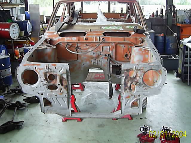

Hi, this my current project. I bought an old corolla KE25, and give him the technology from a Ae86.
Here are some Pics.

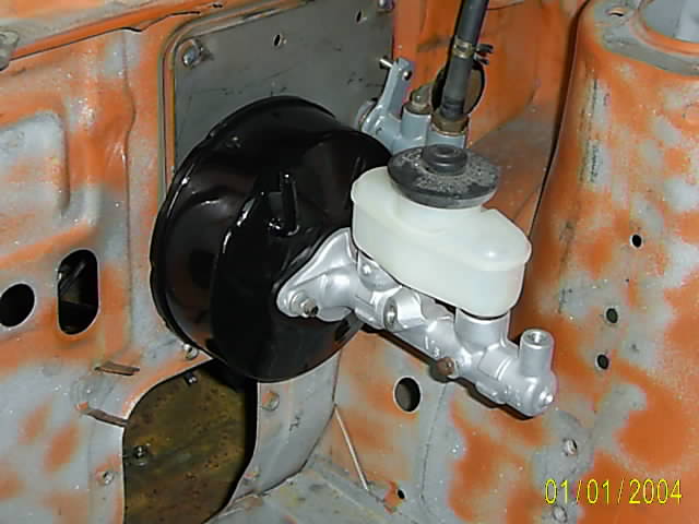

What gearbox are you using and what solution are you using for the hydraulic clutch?
I'm installing my old 4age in my brothers KE 25 too, but we need to find a nice solution for the clutch.
11-29-2009, 03:28 PM
AE86+KE25 = KE86
I have a TE27 pedal box via Japan for mine. You could source a LHD pedal box via the USA. Have also pickeed up a brake booster and master from japan. The problem with right hand drive cars is that room between the carbs and the strut tower is very tight with a 2TG, and no doubt for a 4AGE.
Try 3TCgarage.com, they come up fairly regularly.

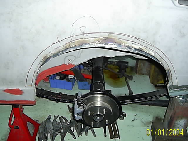

What width did you cut your diff down to?
11-29-2009, 04:38 PM
AE86+KE25 = KE86
Just use a Celica TA22 GT axle. They are the TE27 axle, but have 5link mounts. Width is perfect for arches and fat rims and the housing accepts complete AE86 LSD pumpkinSmile they are pretty cheap too.

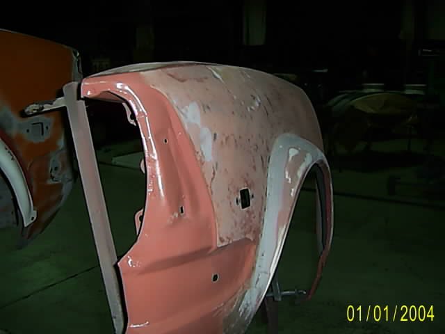

My Brake and Clutchmaster is from an Starlet ep7. gearbox is the orginal from Ae86
12-01-2009, 02:40 PM
AE86+KE25 = KE86

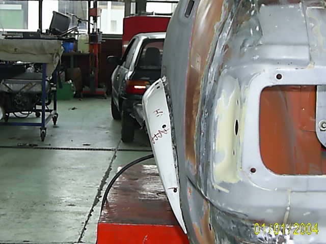

Where are the arches from?
