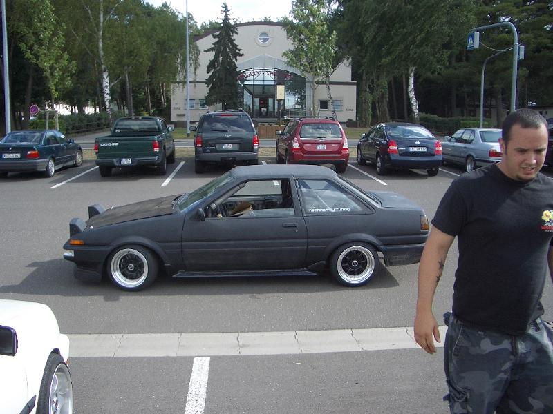

Post: #50
7mgte corolla
this projects AWSOME!
