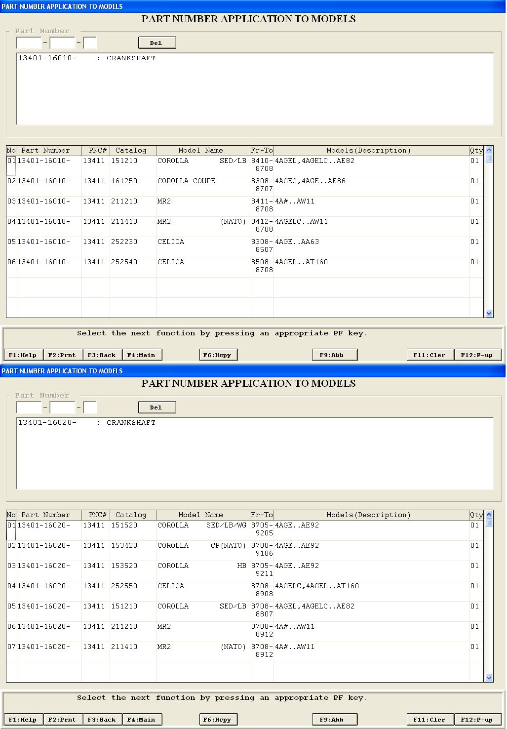

I've made a search to the 2 crankshaft part numbers and there were no small crankshafts after 87. please look at the picture:

I've had a 3-rib ae92 4age in my hachi, and a 7-ribbed ae82 4age after that.
Both had small internals.. I dont get the impression that 7-rib blocks wiith small internals are that rare around here.
