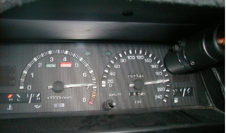

My Hachi goes 198 km/h at 7200 rpm, tested with a GPS-tracker. Allthough the odometer shows nearly 220, it will not go more than 198 (with 3 gyus in the car) Smile
12-04-2004, 02:39 AM
2nd gear
12-04-2004, 02:52 AM
2nd gear
Hehe, i know my odometer is f@£ked up.. Yours is probably more realistic..
Found a picture i thought you should see Tongue
