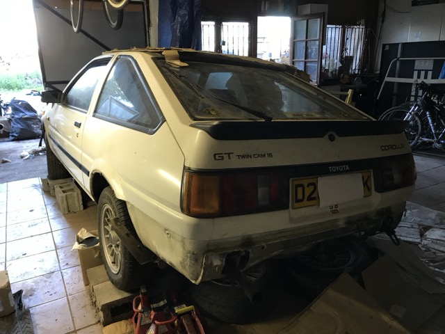

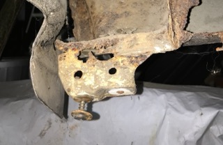

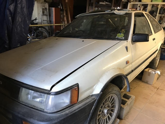

Hi, I’ve finally started on the car, cleared around it and raised it up a bit. It doesn’t seem too bad from a quick look but we shall see what we find underneath. The fuel tank has been removed and doesn’t seem too bad but had to cut one fuel pipe to remove it. Any advice on cleaning out and treating the inside would be appreciated. The fuel filler pipe will be a problem as the seal is not good and I understand isn’t available. The pockets are holed but repairable hopefully by someone with no experience of bodywork. But the small brackets just behind the wheel at the front of the wheel arch will be a problem. I’ll investigate a bit more over the next few days before I decide how to proceed.

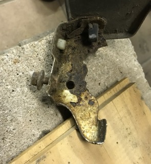

01-11-2026, 08:45 PM (This post was last modified: 01-11-2026 08:53 PM by KSB.)
1987 uk Corolla

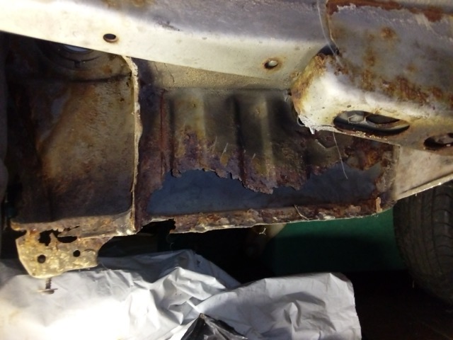

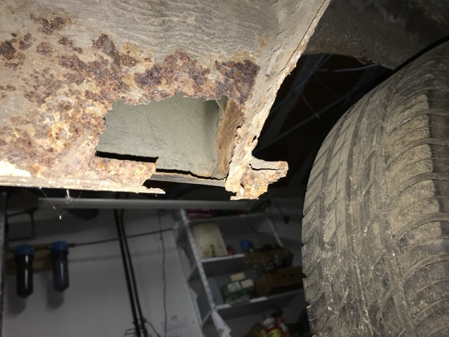

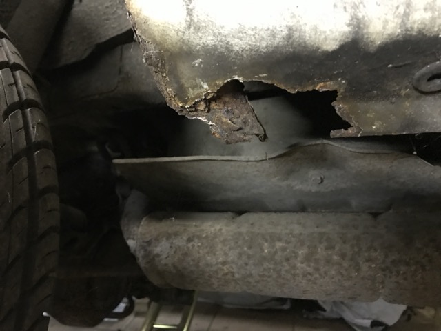

The pockets are a bit worse than I thought but the right side although looking worse, will I think be the easiest to repair. The left side is holed on both the inner and outer panels and the bottom corner bracket is in very bad shape. Ive got the inner panels from Flo’s so I can cut out the bits I need but I guess the outside panel will need a patch made from scratch.
These are the brackets at the bottom of the outer rear panels. The right one might be salvageable but I think the left is beyond repair.
