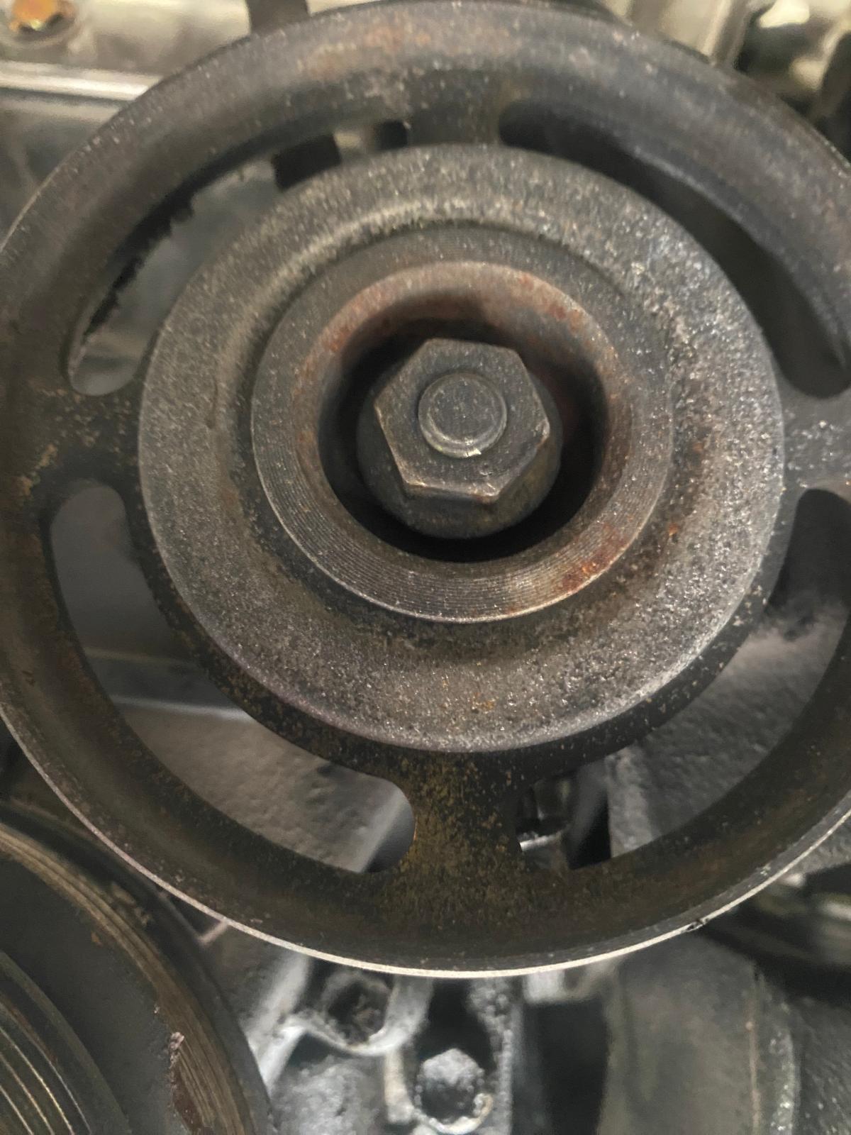

Hi All,
Does anyone know somewhere online that has the above in stock ? Flos don't have them currently, and I'm in the process of changing belts etc. Or does anyone know the part number ? its 110mm in diameter. Thanks -MK7 GTi -Evo 5 -AE86 Levin |

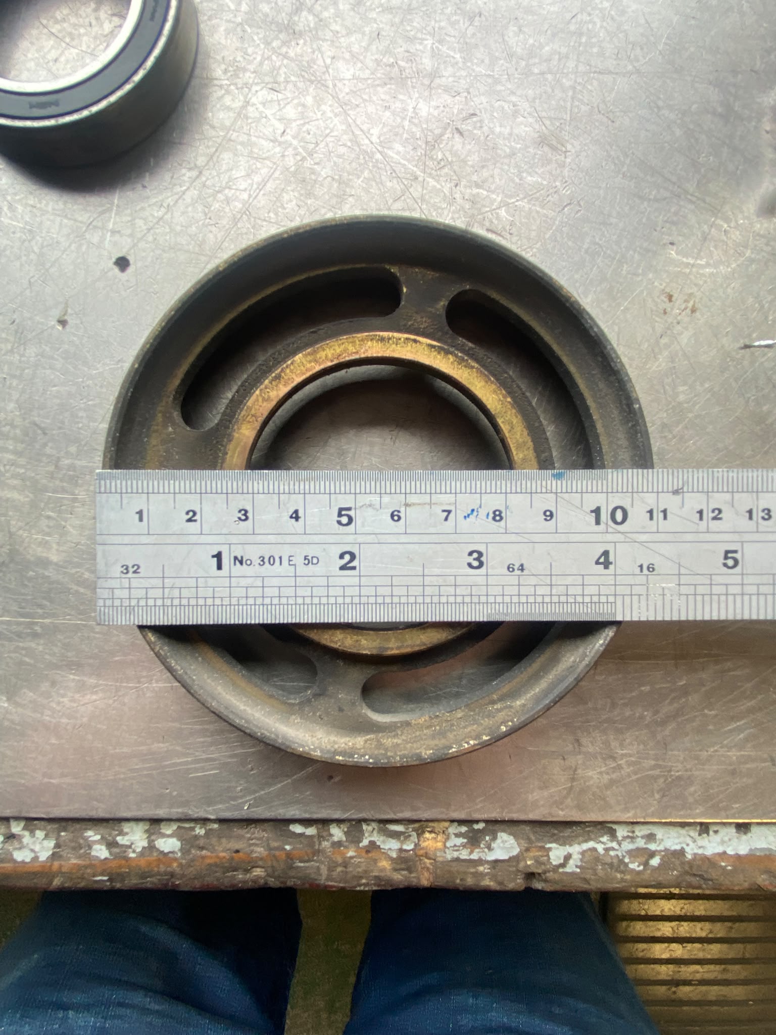

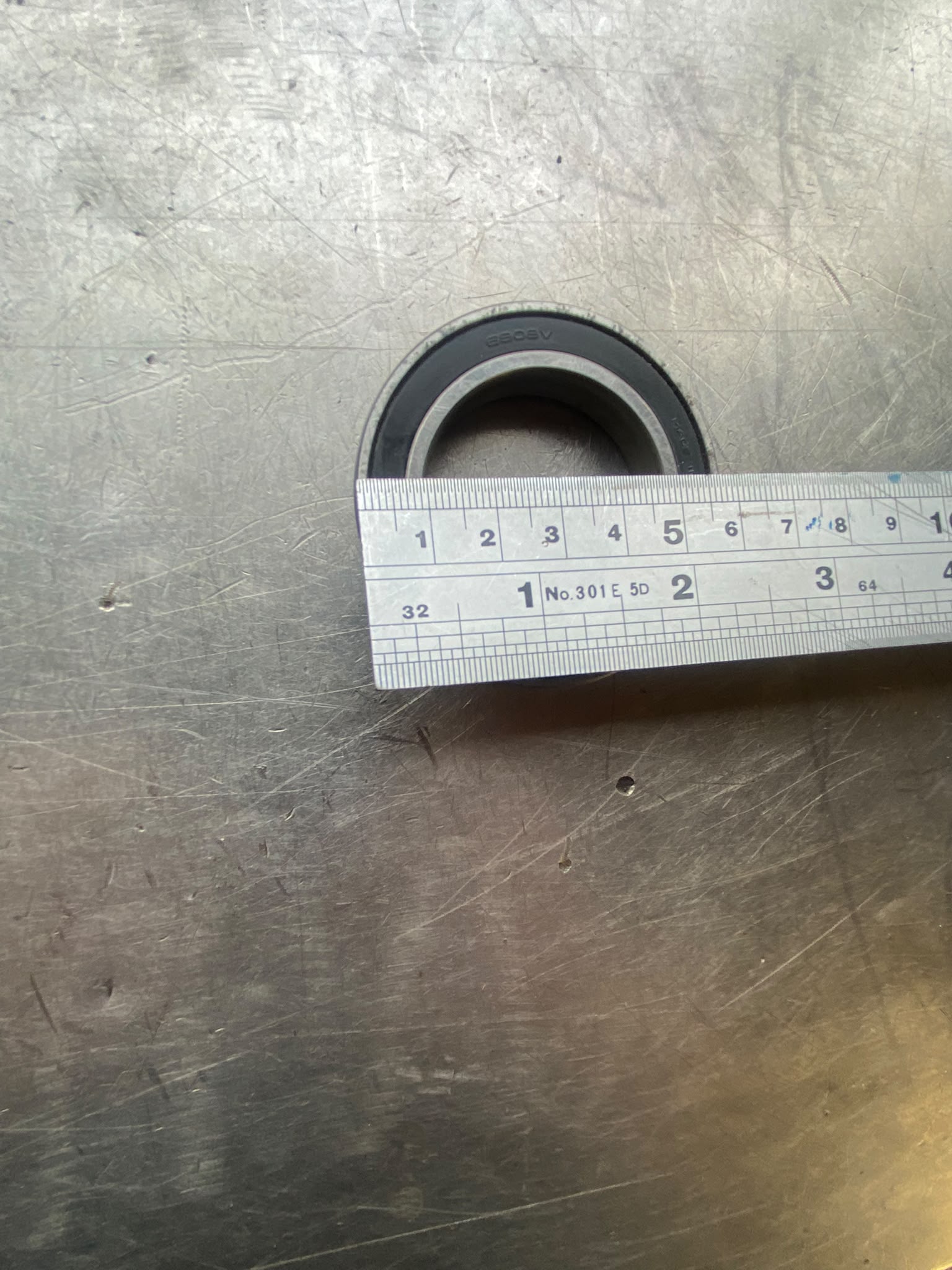

thanks BanPei - this is for the powersteering and aircon pulley.
I've 2 more photos - one with the bearing removed from the pulley. Any help appreciated to identifiy the bearing ? -MK7 GTi -Evo 5 -AE86 Levin |

i got sorted in the end
we found the bearing number written in the rubber. for reference its 6908-2RS Getting all the belts done currently - so while there getting a few other jobs done. -MK7 GTi -Evo 5 -AE86 Levin |
