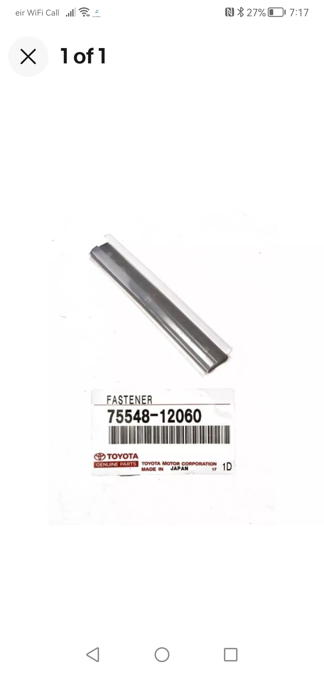

[Image: AEU86 AE86 - Windscreen stoopid(?) questions....]
This is the fastener.....
The clip on the right hand side is what came with the moulding

As you can see from the last illustration the clip that comes with the moulding only goes in 3 places at those places there's no fastener.

@Blaze0010 and @Bean, thanks lads! That helps. Do you think that the fasteners are there to ensure a certain distance from the roof? I'm sure there are other occasions where Toyota use words to name things that don't actually describe what they do....
