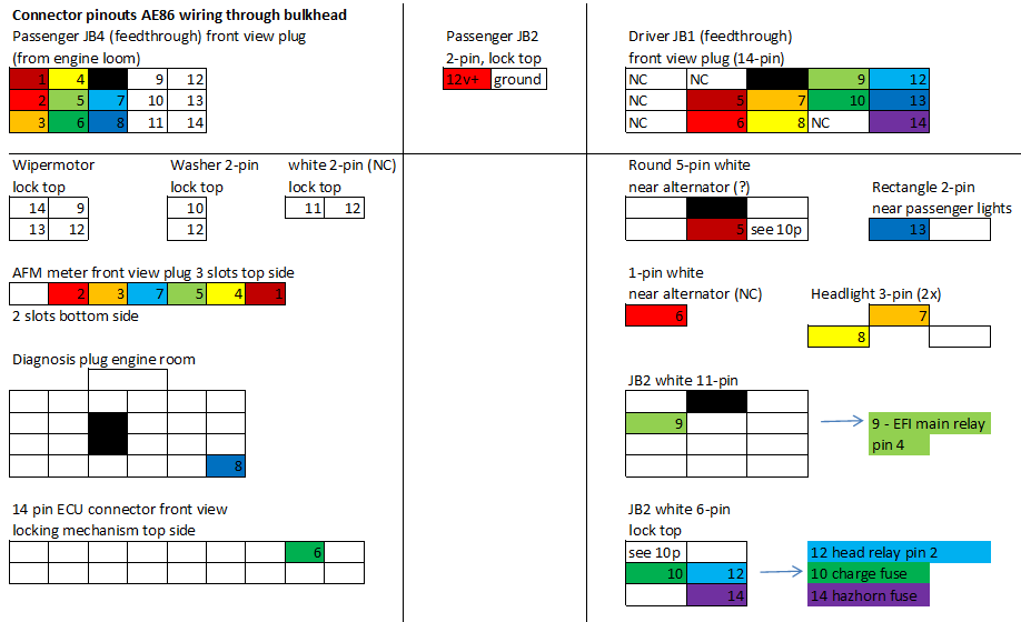

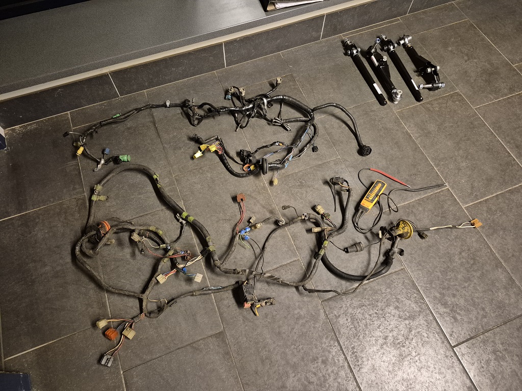

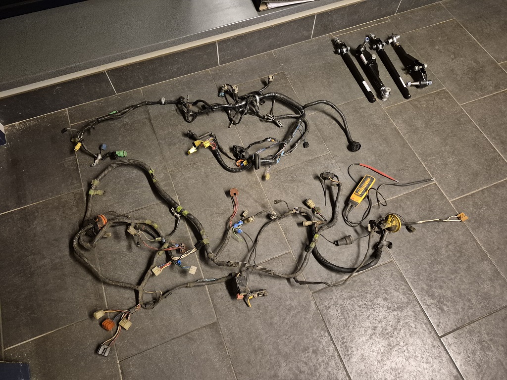

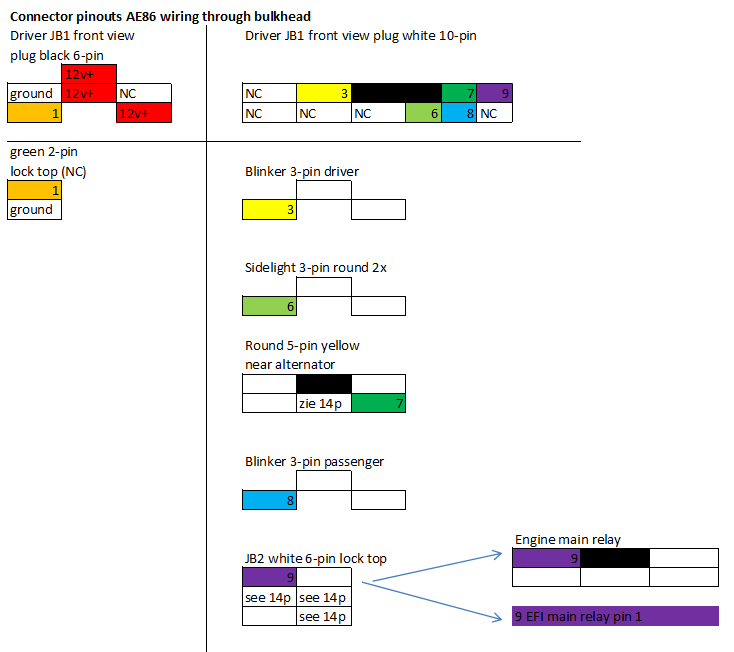

![]() ![]() Luckily I had both looms in storage as a spare so this made measuring a bit easier. Some connectors are still unknown for me (they are not attached to anything in my car) and some are missing completely (I guess the spare engine bay loom is zenki and the car kouki) so this is definitely not complete or fully correct. But it holds the information that I need to make new looms for my car. ![]() ![]() Use at your own risk I don't know anything about this for specific wiring issues. My goal was figuring out which pins to feed 12v in JB1 and JB4 and which pins to use to control the lights/wiper/washer with the original switches.
