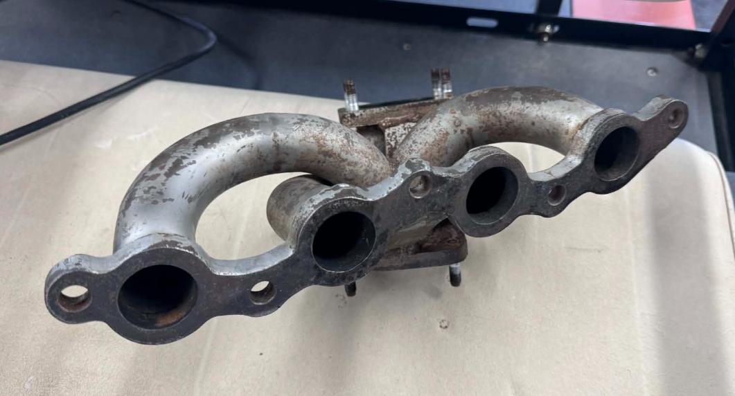

I was looking into the Yaz twin turbo manifold and found these photos by you in another thread on another forum:
That's some interesting manifold: not a sequential twin turbo, but one feeds the outer cylinders and the other one feeds the inner cylinders! 1983 - AE86 Sprinter Trueno - import project 2013 - Honda Civic sport - daily driver 2004 - AEU86 dot ORG - daily domain Support our forum, buy from the AEU86 shop:
10-07-2026, 01:13 AM
(This post was last modified: 10-07-2026 01:18 AM by oldeskewltoy.)
OST-125: Building a big valve 5AGTTE (yes, twin turbocharged)
Quote:That's some interesting manifold: not a sequential twin turbo, but one feeds the outer cylinders and the other one feeds the inner cylinders! Huh Remember the firing order 1-3-4-2. The manifold feeds the turbos with alternating exhaust pulses. This, in theory should spool the twins simultaneously.... upto a reported 22 PSI The Yaz kit was available over 20 years ago, and for a bit more info here is a write up from someone else who built their engine around that kit: https://www.driftworks.com/forum/threads...-go.32177/ So, the 1st photo of the manifold with a gasket affixed ![]() Top panel shows how much porting the manifold required to fit to the "new" exhaust ports on the big valve head. After porting, all the flanges were machined for perfect flat fitment. Last, the manifold was sent to Jet-Hot to get their most durable heat coating. ![]() more to come.....

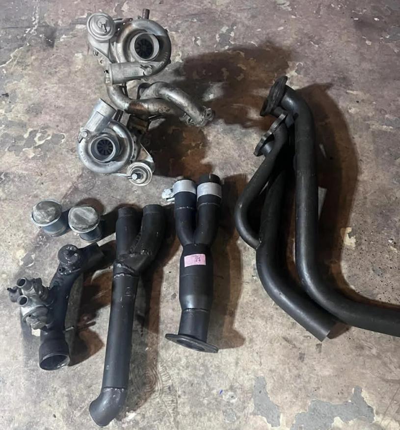

My client already has had the turbos rebuilt
![]() ![]() (10-07-2026 01:13 AM)oldeskewltoy Wrote: [ -> ]The Yaz kit was available over 20 years ago, and for a bit more info here is a write up from someone else who built their engine around that kit: https://www.driftworks.com/forum/threads...-go.32177/ Their goal was around 280-300ps. Considering they used 4AGZE internals: pistons, rods crank, and 4AGZE injectors, and apparently stock cams and valves. Our goal of 400hp might just be attainable. So here are some of the parts being used for the 5AGTTE build.... HKS stroker crankshaft(83mm stroke versus 77mm), along with a set of Molnar Technologies rods ![]() A set of custom made pistons with a negative 6cc dome. - Due to the stroker crankshaft, the wrist pin location requires moving it. Negative 6cc dome provides a 10.14 static CR. ![]() A set of big valves, 32mm intake (stock is 30.5), and a custom made set of Inconel 28mm exhaust (stock is 25.5) valves. ![]() The cams... are Kelford 193HV-T ![]() More to come..... Dan - You can | OST Porting service - http://hachiroku.net/forums/showthread.php?t=19991 |

(10-13-2026 08:23 AM)Koen Wrote: [ -> ]Very cool and special engine build For maximum performance, highly unlikely, as they are too small to build significant power. A newer, large twin scroll would likely make more power. I'm pretty sure my client wants this build based on how unique this manifold/twin turbo kit was. As to fitment, it is going into a rhd AE86, it won't fit a LHD car, and fitting to anything other than an AE86, or AA63 would require modifying the existing ancillaries. (10-07-2026 05:20 PM)oldeskewltoy Wrote: [ -> ]The cams... are Kelford 193HV-T Let me show you what is needed to fit those Kelford cams..... All the bucket bores needed clearancing.... adding room so the cams can rotate without hitting the head. Even one of the reinforcing ribs (around #1 exhaust valve/distributor area) needed extra clearance. ![]() More to come...
