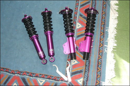

I myself have a Nissan cefiro with custom paint, 17' wheels, Fully adjustable drift spec suspention along with adjustable camper and damper, 5 speed manuel conversion, custom speedometer callobration box, 5' exhaust, modified interiour, new tyres, light engine upgrades and a few more other things.
In New Zealand and im sure other countries these modification parts are easy to get a hold of.
Some tips if you would like to modify your own Cefiro and cannot get a hold of cefiro parts, it is possible to get adjustable suspention for a sivia of any year which will fit easily into the cefiro. Also skyline brakes and interiour seats will bolt in without any custom work. It is also easy to mould the r32 skyline model 4 door bodykits to fit the a31 cefiro.

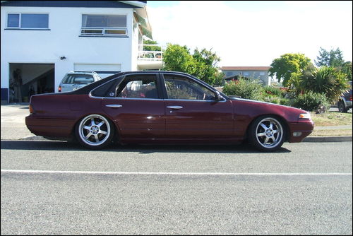

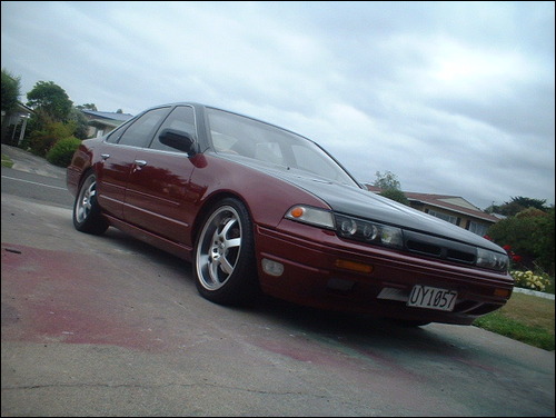

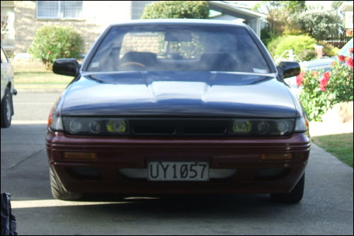

Here are a few pics of my a31 cefiro. Still have a few mods i would like to make tho.
Enjoy!!!
