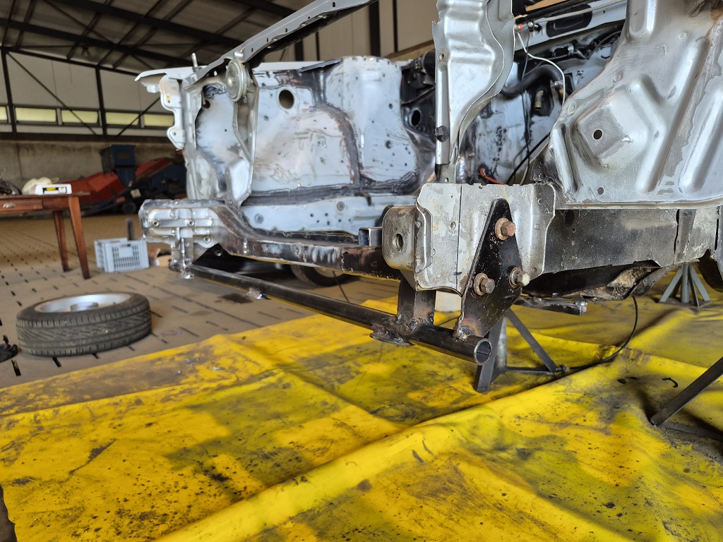

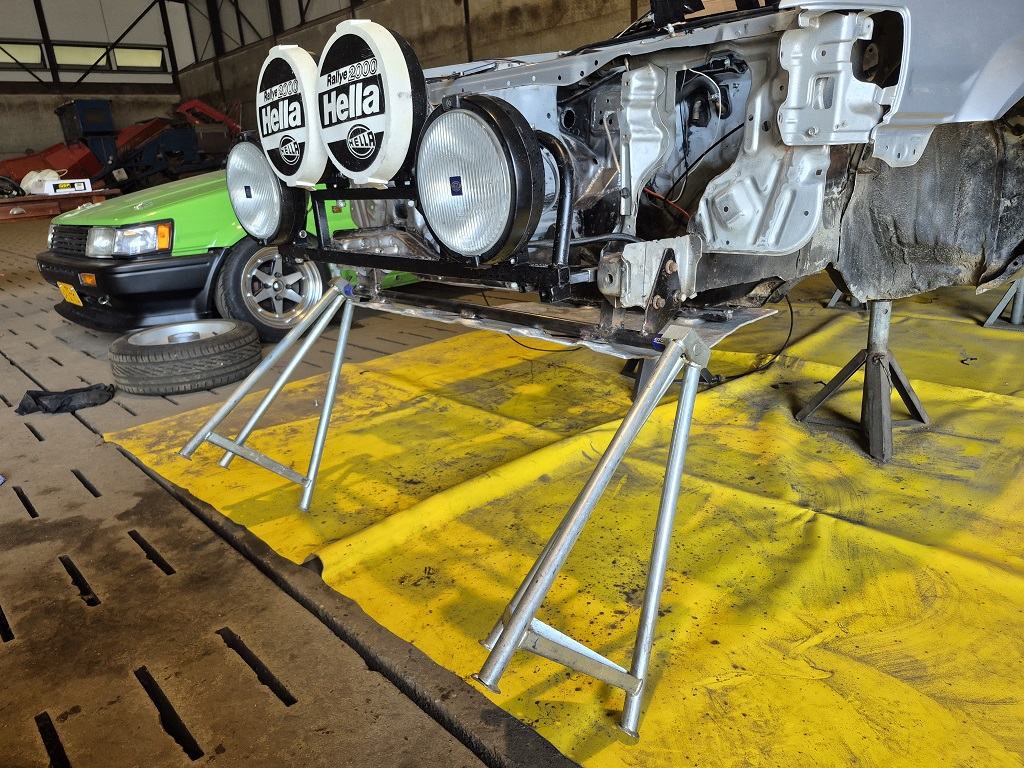

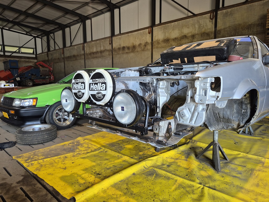

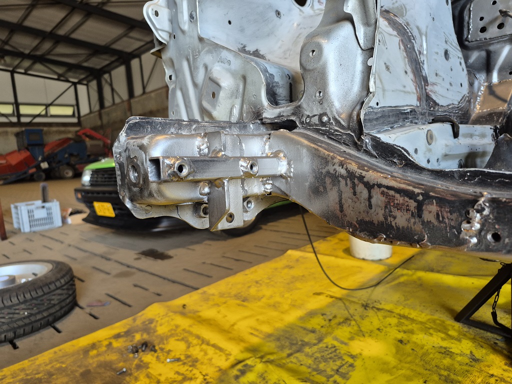

Did some more work in the engine compartment.

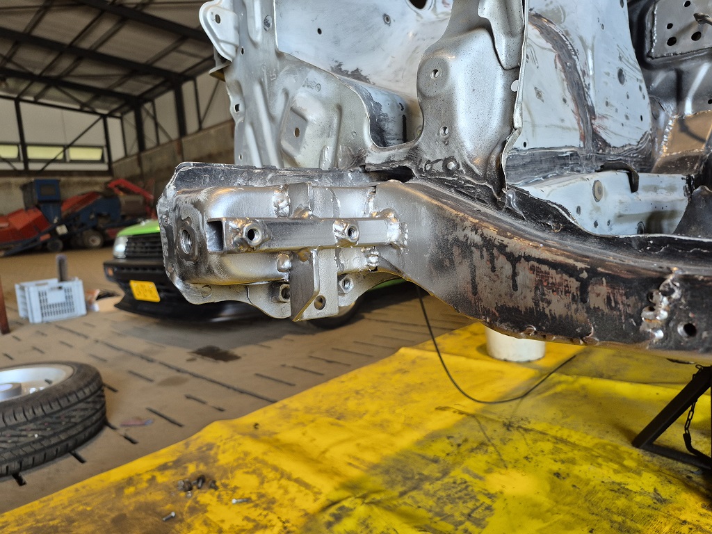

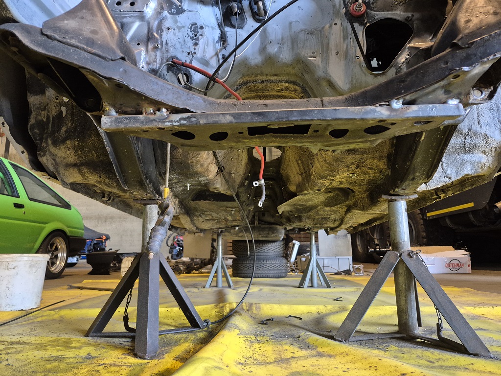

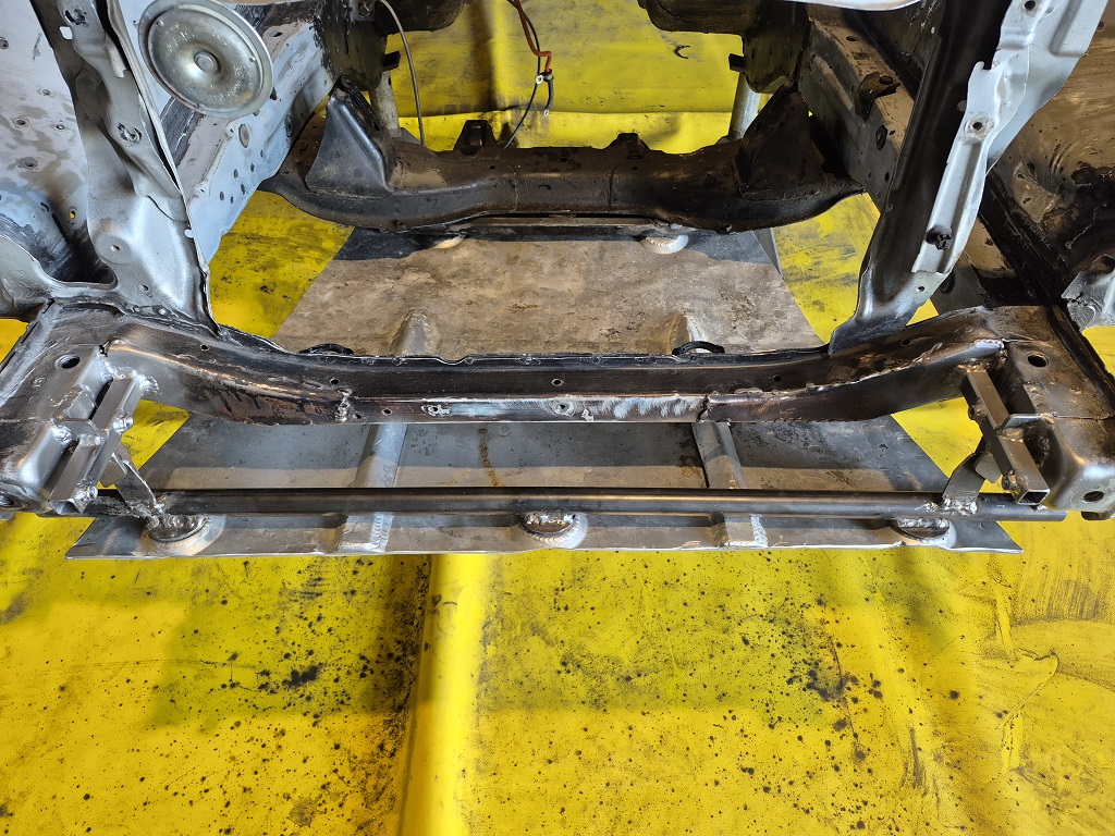

The car doesn't have supports for a lightbar so I have to make some. And while we're there, I've changed the sump guard a bit and added provisions for rallystands. I've made a lightbar for the other car as mentioned before. There's a low chance that I need two at the same moment so I just copied the mounting points. Now I can use that one on this car also. ![]() Here you see what I've made. It's just a square tube with some nuts welded to it and attached to the chassis. the L-shaped holder is also used to support the bar for the sump guard. The sump guard is just a big aluminium plate attached to the car. The bolts are recessed to prevent them from wearing away when you hit stuff. It's held by 5 bolts. ![]() This is the rear mount. It's welded to the front subframe. This is what the previous owner made. I just added some more welds. The front bar used to be a square tube which was fine. But since I wanted to add the rally stands it was easier to make a new one out of a round tube. ![]() I reused the plates he made that attach to the chassis. Added some 3mm circles that line up with the supports of the sump guard and added an extra support to the bracket that holds the lightbar. ![]() As you can see, it now fits to the car ![]() ![]() The lightbar fits too! ![]() And the rally stands can go in the tube. So this is done! Now I have to receive the bulkhead connectors for the wiring after fitting those I should be ready for paint I don't like the matt black rattle can job the previous owner did. I'll just make it RAL silver.

Nice!
How do these lights line up? To me, they seem to be lower, in front of the bumper instead of the grill. (so different from the Irish-spec) 1983 - AE86 Sprinter Trueno - import project 2013 - Honda Civic sport - daily driver 2004 - AEU86 dot ORG - daily domain Support our forum, buy from the AEU86 shop:
