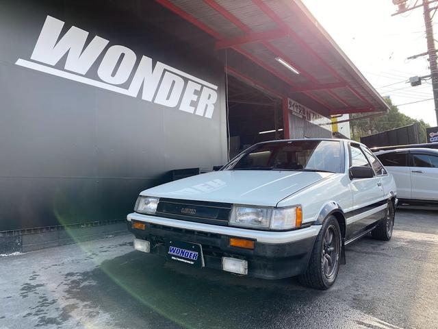

But then I searched on Goo-net and the third zenki Levin I checked had the brows on the bonnet! Hurray!

Both cars are 1983 pre-August facelift (they have square door mirrors). And I also found them on lower grade JDM cars like the three door SR
However if you look better to the not-so-shabby first one, the brows aren't even noticable:

So I don't think these brows are for cosmetic purposes, but rather to close the gap between the headlights and the bonnet. I could be wrong here, but it could then direct the airflow towards the center (radiator) instead of going into the enginebay.
So my guess is all zenki AE86s have these brows on the bonnet, but this doesn't explain why they are missing on so many of them... Perhaps some countries were cheapskates?

I think you hit the nail on the head there Art, you dont see these things from outside, they are very likely just there for aerodynamic purposes. Namely restricting high pressure air
from entering the engine bay through any way other than through the radiator. A rather important thing if you want to optimize cooling performance.
