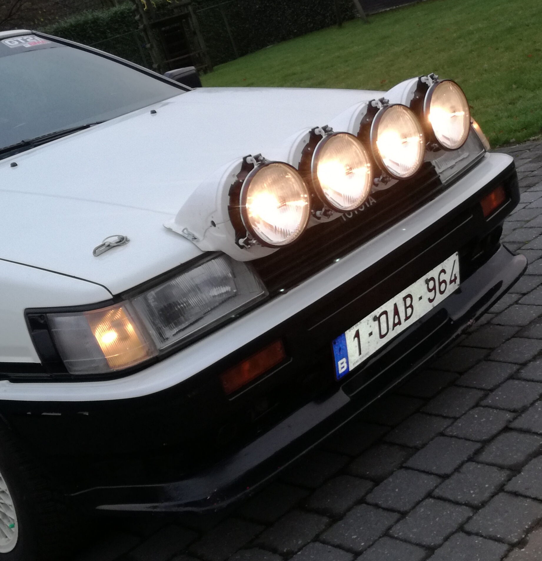

Lamp pods for AE86 are difficult / impossible to find (for me at least Wink ). So in case some one has plans to install one someday here is my setup.
Pod is original from Renault 5 GT Turbo and it's as good as plug & shine Smile.
As you can see, the angle at the back is a bit off but using DZUS slide latch makes it fit firmly and it can be installed/removed in a few seconds Cool
I attached two staybars to the bumper with quick connection to reduce vibration but it wasn't too bad without also.
