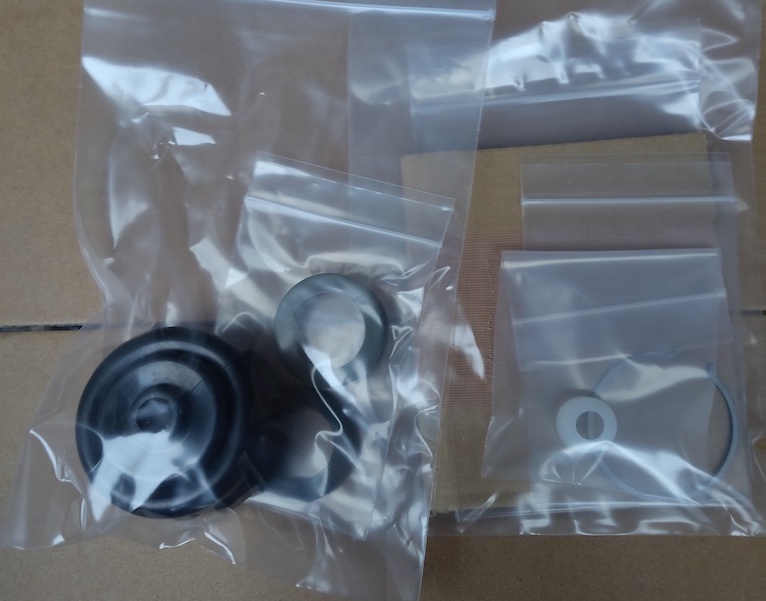

Also, this shifter rebuild kit arrived:
[Image: AEU86 AE86 - Banpei's two door panda Trueno from Japan]
The shifter is still rattling from time to time. When I replaced the TRD shortshifter with a C's shifter plus original baseplate, I lacked a new snap ring to lock things in place. Instead, I reused the ring on the TRD shortshifter. I suspect this ring might be thinner than the OEM ring, causing the shifter to have a little bit of play. The other suspicion is that the spring inside the C's shifter isn't strong enough and therefore needs a stronger spring or spacer installed.
As I tried to order the snap ring from Toyota, I was quoted a depressing amount of money and an expected time of arrival of a few weeks. I vividly remember the polyurethane cup for the shifter taking two extra weeks to arrive, on top of the estimated ten days. Anyway, I found a rebuild kit in Japan to be slightly more expensive, but then I would have all the necessary parts ready if the shift lever ball seat on the original baseplate has pitted due to the rattling. Another project for next year.
