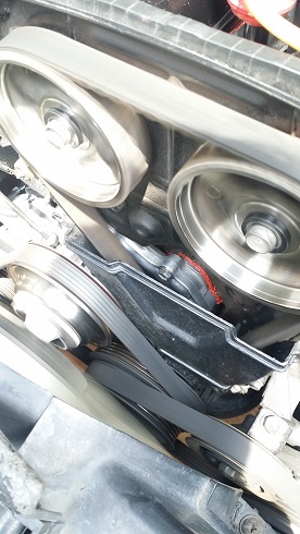

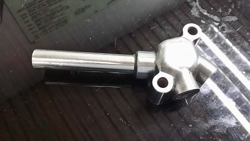

Dear Guys, below as some of the photo of the overhaul water cooling system parts. tq
