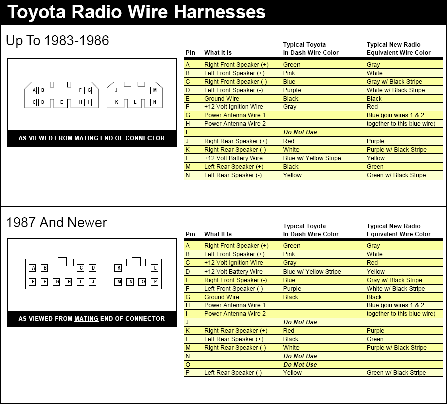

As title really, does anyone know of a convienient place to
pick up a 12v ignition switched feed from? Ideally inside the cabin Thanks An analogue brain in a digital World |

I think most people use the 12V line from the radio:
Pin F is the ignition wire and a 10 amp fuse should fuse this. 1983 - AE86 Sprinter Trueno - import project 2013 - Honda Civic sport - daily driver 2004 - AEU86 dot ORG - daily domain Support our forum, buy from the AEU86 shop: |

Ah great, thank you.
