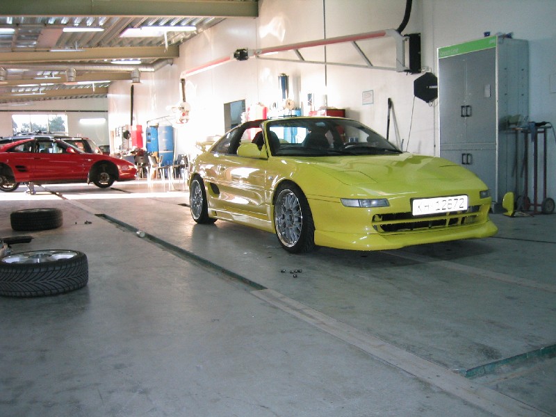

Had a "little" accident with my MR2 right about the time I was starting on this project, causing me a bit of a delay (and a huge hole in my pocket...) Confused
Viewed 132 Time(s)
Viewed 85 Time(s)
