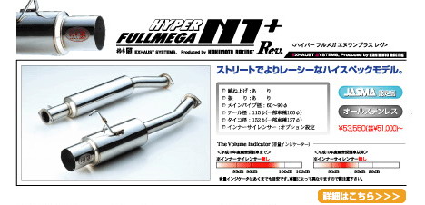

Hi guys,
I have to buy new exhaust.
I consider:
- Kakimoto N1 (from Speed industries)
- Greddy Extreme 2 (from Speed industries)
- Greddy Ti-C (from US). says its for us bumper Neutral
- Apexi Hybrid Megaphone Evo (from Pass)
I expect sporty but not extremely loud exhaust since I like engine (ITB) sound more.
Does anybody have experience with some?
Thx

Kakimoto N1
Kakimoto N1

If your car is mega low go for the first 2 as they go over axle, i would go for Kakimoto they are usually not too noisy.

Ah,
so Apexi and Greddy Extreme 2 are above rear axle, if I understand well.
As for Apexi, I didnt get reply from pass about shipping yet
I also likr Kakimoto a lot even under axle, but the cost Crying or Very sad

The Kakimoto N1 falls apart from what Ive seen,

Realy? Ive always considered Kakimoto and Fujitsubo as best.

The Kakimoto looks the job but Ive seen alot of them on Jap imports & they usually are worst for wear
